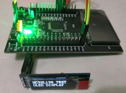

實(shí)現(xiàn)圖1顯示效果的主程序?yàn)椋?/font>
  1. int32_t main(void)
  2. {
  3. stc_rtc_time_t readtime;
  4. Sysctrl_SetPeripheralGate(SysctrlPeripheralGpio,TRUE);  //GPIO外設(shè)時(shí)鐘打開
  5. Sysctrl_SetPeripheralGate(SysctrlPeripheralRtc,TRUE);    //RTC模塊時(shí)鐘打開
  6. Sysctrl_ClkSourceEnable(SysctrlClkRCL, TRUE);
  7. RTC_Cfg();                                        //配置RTC
  8. EnableNvic(RTC_IRQn, IrqLevel3, TRUE);                //使能RTC中斷向量
  9. Rtc_Cmd(TRUE);                                   //使能RTC開始計(jì)數(shù)
  10. App_OledInit();
  11. OLED_Init();
  12. OLED_Clear();
  13. OLED_ShowString(0,0,"HC32L136 TEST",16);
  14. OLED_ShowString(0,2,"OLED DISPLAY",16);
  15. while (1);
  16. }
1  OLED屏顯示效果

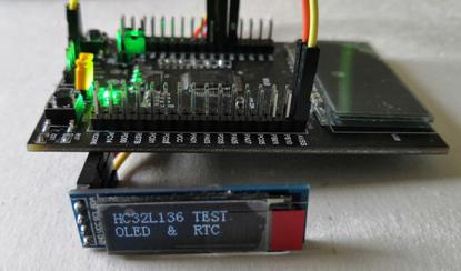

實(shí)現(xiàn)圖3  RTC計(jì)時(shí)效果的主程序?yàn)椋?/font>
  2. {
  10. App_OledInit();
  11. OLED_Init();
  12. OLED_Clear();
  14. OLED_ShowString(0,2,"OLED  &  RTC",16);
  15. delay1ms(2000);
  16. OLED_Clear();

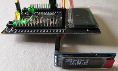

  17. OLED_ShowString(0,0,"20  -  -",16);
  18. OLED_ShowString(0,2,"    :  :",16);
  19. while (1)
  20. {
  21. if(flag == 1)
  22. {
  23. flag = 0;

2  RTC起始界面
3  RTC計(jì)時(shí)效果
