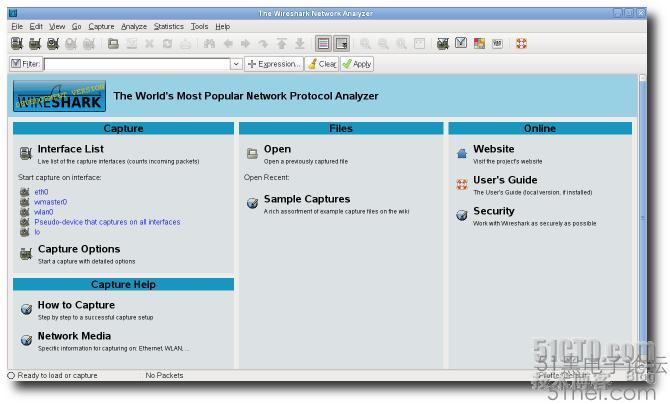

四、運(yùn)行
/usr/local/wireshark/bin/wireshark
