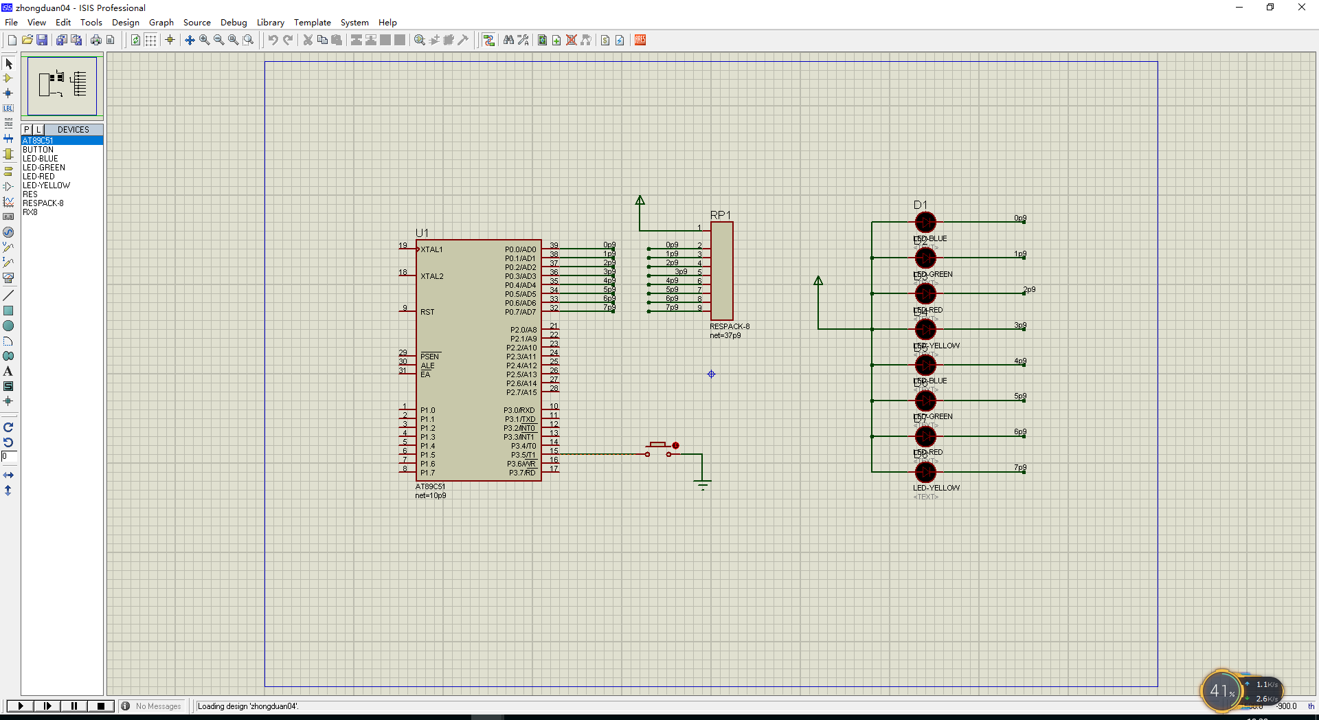

標(biāo)題: c51單片機(jī)之計數(shù)器,按4次按鍵燈才會亮
#include<reg51.h>
#define uchar unsigned char
#define uint unsigned int
void delay(uint i)
  uint j;
  for(;i>0;i--);
void main()
     TMOD=0X50;
     TH1=0XFF;
     TL1=0XFC;
     EA=1;
     ET1=1;
     TR1=1;
     while(1);
void T1_int(void)  interrupt 3
   for(;;)
     P0=0XFF;
   delay(500);
   P0=0;
   delay(500);
