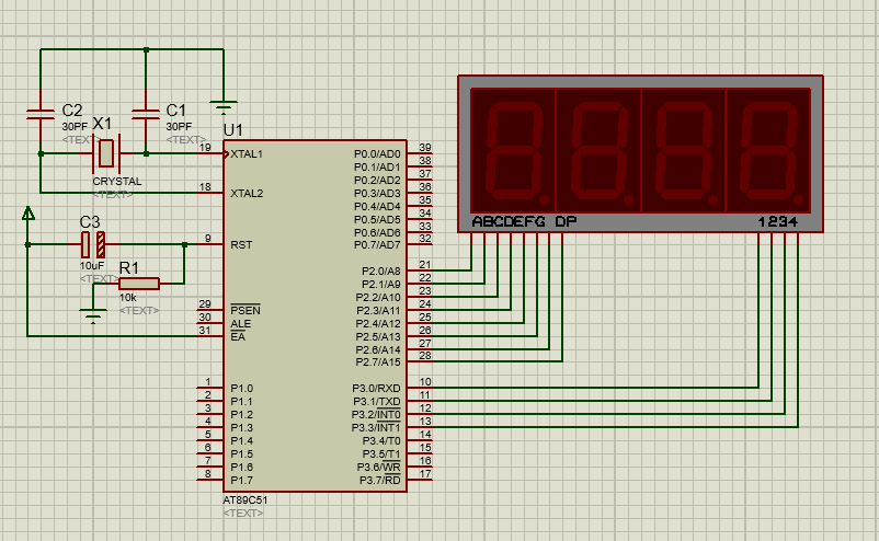

C51單片機做的這玩意不亮啊,是我代碼問題嗎,還是控制不了四個數(shù)碼管

#include<reg51.h> char led_mod[]={0x5b,0x3f,0x06,0x7f}; void delay(unsigned int time) {         unsigned int j;         {   & ...

at89c51不能直接高電位驅(qū)動
ID:7485 發(fā)表于 2018-10-25 09:05
你的程序自己看得懂嗎?
at89c51不能直接高電位驅(qū)動位選。
ID:213173 發(fā)表于 2018-10-25 07:29
#include<reg51.h>
unsigned char  code table[]={//共陰段碼
        0x3f,0x06,0x5b,0x4f,0x66,0x6d,0x7d,0x07,
        0x7f,0x6f,0x77,0x7c,0x39,0x5e,0x79,0x71};
unsigned char led_mod[]={0xfe,0xfd,0xfb,0xf7};//位碼
        unsigned int j;
                for(j=0;j<time;j++);
void main()
        unsigned char i;
        while(1)
                for(i=0;i<4;i++)
                        P2=0x00;//消隱
                        P3=led_mod;//送位碼
                        P2=table;//送段碼
                        delay(240);//延時2ms
