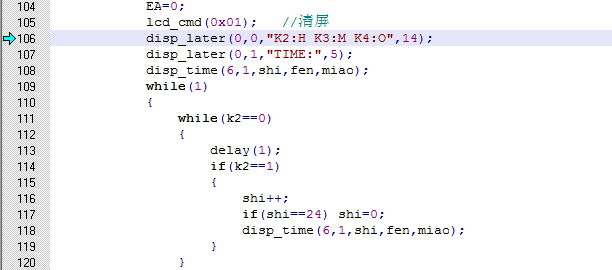

keil編譯錯(cuò)誤,有大佬可以幫我改一下程序嗎?

給你改了一下試試。
  1. #include <reg51.h>
  2. #define uint unsigned int
  4. unsigned int cnt_num;
  5. sbit rs=P2^0;
  6. sbit rw=P2^1;
  7. sbit ep=P2^2;
  8. sbit led=P2^5;
  9. sbit k1=P3^0;
  10. sbit k2=P3^1;
  11. sbit k3=P3^2;
  12. sbit k4=P3^3;
  13. sbit bz=P2^3;
  14. sbit power=P2^4;
  15. uchar shi,fen,miao,a,b,c,d,e,f,teep,ling;
  16. uchar code table[]={"0123456789:"};
  17. void disp_later(uchar x,uchar y,uchar *p,uchar n);  //<-------

  212.                                         {
  213.                                                 if(fen==b+d)
  214.                                                 {
  215.                                                         power=1;                 //關(guān)電源
  216.                                                         led=0;
  217.                                                         bz =0 ;
  218.                                                         delay(1000);
  219.                                                         bz =1 ;
  220.                                                         lcd_cmd(0x01);   //清屏
  221.                                                         disp_later(0,0,"1-SET 2-AL 3-SAL",16);
  222.                                                         disp_later(0,1,"TIME:",5);
  223.                                                         disp_time(6,1,shi,fen,miao);
  224.                                                         ling=0;
  225.                                                 }
  226.                                         }
  227.                                 }
  228.                         }
  229.                 }
  230.         } //<-----
  231. } //<-----
  232. void timer0() interrupt 1
  233. {
  234.         TH0=(65536-50000)/256;
  235.         TL0=(65536-50000)%256;
  236.         teep++;
  237.         led=0;
  238.         if(teep==20)
  239.         {
  240.                 teep=0;
  241.                 miao++;    //秒加一
  242.                 if(miao==60)
  243.                 {
  244.                         miao=0;
  245.                         fen++;
  246.                         if(fen==60)
  247.                         {
  248.                                 fen=0;
  249.                                 shi++;
  250.                                 if(shi==24)
  251.                                 {
  252.                                         shi=0;
  253.                                 }
  254.                         }
  255.                 }
  256.         }
  257. }
ID:134430 發(fā)表于 2019-1-19 07:24
main函數(shù)吶?
