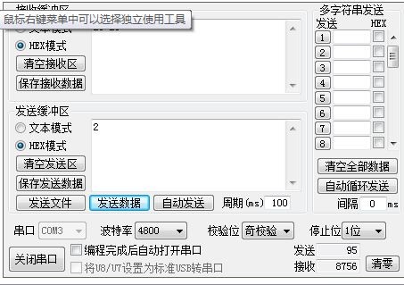

11F04E單片機(jī)串口通訊,發(fā)送1,回傳數(shù)據(jù)混亂沒有規(guī)則,串口初始化有問題嗎?
查看數(shù): 1306 | 評論數(shù): 2 | 收藏 0
發(fā)布時間: 2020-4-5 08:54
#include "reg52.h" #include "intrins.h" void Usartinit() {SCON=0x50; TMOD=0X20; TL1 = 0xD7; //設(shè)定定時初值 TH1 = 0xFE; //設(shè)定定時初值 TR1=1; ES=1; EA=1; } void main(){ UsartInit();w ...
