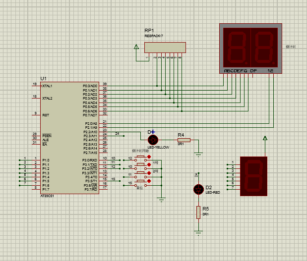

要做一個(gè)搶答器,60秒倒計(jì)時(shí)結(jié)束后紅燈亮,但數(shù)碼管不滅,想問(wèn)一下怎么解決?
ID:70069 發(fā)表于 2020-4-18 10:15
flag=4;//開始賦值為4,修復(fù)啟動(dòng)時(shí)要先按復(fù)位鍵BUG
        while(1)
ID:70069 發(fā)表于 2020-4-18 10:06
while(1)
                 if(flag!=0)
                      if(key1==0)
                            delay10ms();
                                if(key1==0)
                                          flag=1;  //開始標(biāo)志
                key_scan();
                switch(flag)
                        case 1:daojishi();break;
                        case 2:yihao();break;
                        case 3:erhao();break;
                        case 4:fuwei();break;
                    else
                    if(key4==0)
                      delay10ms();
                        if(key4==0)
                            flag=4;        //復(fù)位標(biāo)志
這樣調(diào)整一下,修復(fù)搶答鍵按下后,再按開始鍵繼續(xù)倒計(jì)時(shí)BUG
ID:70069 發(fā)表于 2020-4-18 09:49
#include <reg51.h>
#define uchar unsigned char
#define uint unsigned int
uchar code zixingma[]={0xc0,0xf9,0xa4,0xb0,0x99,0x92,0x82,0xf8,0x80,0x90};
sbit P20=P2^0;
sbit P21=P2^1;
sbit P22=P2^2;                                                         //黃燈
sbit P23=P2^3;                                                         //紅燈
sbit P26=P2^6;
sbit P27=P2^7;
sbit key1=P3^2;                                                         //倒計(jì)時(shí)開關(guān)
sbit key2=P3^0;                                                         //1
sbit key3=P3^1;                                                         //2
sbit key4=P3^5;                                                         //復(fù)位開關(guān)
void daojishi(void);
void yihao(void);
void erhao(void);
void fuwei(void);
void key_scan(void);
uchar n,k,flag;
void delay5ms()
        uchar i,j;
        for(i=10;i>0;i--)
        for(j=248;j>0;j--);
void delay10ms()
        unsigned char i,j;
        for(i=20;i>0;i--)
        for(j=248;j>0;j--);
void main()
        n=60;
        k=20;
        P22=0;
        P23=0;
        P1=0xff;
        TMOD=0x01;                                           //T0用中斷定時(shí)1s,方式一
        TH0=(65536-50000)/256;
        TL0=(65536-50000)%256;
        IE=0x8f;
        IT0=1;
        IT1=1;
        flag=0;
        while(1)
                          if(key1==0)
                    delay10ms();
                      if(key1==0)
                 if(flag!=0)
                key_scan();
                switch(flag)
                    else
                    if(key4==0)
                      delay10ms();
                        if(key4==0)
void t_0() interrupt 1
        k--;
        if(k==0)
                k=20;
                if(n>0)             //增加一個(gè)判斷
                    {n--;}
                     else
                   /* n--;
                        if(n==0)        */
                        TR0=0;
                        P23=1;
                        P0=0xff;
                                flag=0;  //禁止除復(fù)位按鈕外其它按鈕        標(biāo)志
void key_scan()
        if(key1==0)
                delay10ms();
                if(key1==0)
                {            flag=1;
                        while(key1==1)
                              delay10ms();
                              flag=0;
        if(key2==0)
                delay10ms();
                if(key2==0)
                         flag=2;
                         while(key2==1)
                                delay10ms();
                                flag=0;
        if(key3==0)
                delay10ms();
                if(key3==0)
                         flag=3;
                         while(key3==1)
                                delay10ms();
                                  flag=0;
        if(key4==0)
                delay10ms();
                if(key4==0)
                        flag=4;
                        while(key4==1)
                                 delay10ms();
                                 flag=0;
void daojishi()
        TR0=1;
        P0=0xff;
        P20=1;
        P21=0;
        if(n>=10)
                P0=zixingma[n/10];
                delay5ms();
        P0=0xff;
        P20=0;
        P21=1;
        P0=zixingma[n%10];
        delay5ms();
void yihao()
        P0=0xff;
        P1=0xf9;
        P22=1;
          flag=0;//禁止除復(fù)位按鈕外其它按鈕        標(biāo)志
void erhao()
        P0=0xff;
        P1=0xa4;
        P22=1;
          flag=0 ;//禁止除復(fù)位按鈕外其它按鈕標(biāo)志
void fuwei()
        TR0=0;
        P2=0;
        P0=0xff;
        P1=0xff;
        n=60;
ID:723431 發(fā)表于 2020-4-17 20:36
本帖最后由 機(jī)電小生 于 2020-4-17 21:35 編輯
程序如下:
