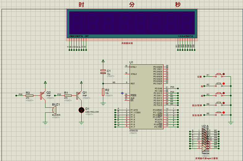

數(shù)碼管在設(shè)置時(shí)狂閃,該怎樣解決啊,或者說(shuō)調(diào)慢點(diǎn) 單片機(jī)源程序如下: #include<reg52.h> #include<intrins.h> #define uchar unsigned char #define uint  unsigned int #define ...

數(shù)碼管閃爍提示的實(shí)際視覺(jué)效果不如閃點(diǎn)好。給你改成數(shù)碼管閃爍提示供參考
問(wèn)題已解決,感謝您的寶貴建議

數(shù)碼管閃爍提示的實(shí)際視覺(jué)效果不如閃點(diǎn)好。給你改成數(shù)碼管閃爍提示供參考 測(cè)試程序 仿真.rar (96.63 KB, 下載次數(shù): 8)

感謝大佬回信,我聽(tīng)你的建議加了在if(key2==0)的else里加了短按判斷if(j>500 && j<3000),秒表問(wèn)題解決,但我時(shí)分顯示也有這個(gè)問(wèn)題,我改了幾次發(fā)現(xiàn)不行不知道怎么改了

  18. uint cont,cont1;
  19. uchar code duanma[]={0x3f,0x06,0x5b,0x4f,0x66,0x6d,0x7d,0x07,0x7f,0x6f};
  20. uchar code weima[]={0x01,0x02,0x04,0x08,0x10,0x20,0x40,0x80};
  21. uchar LedBuff[8];
  22. void init()
  23. {
  24.         TMOD |= 0x01;
  25.         TH0 = (65536-1000)/256;
  26.         TL0 = (65536-1000)%256;
  27.         EA = 1;
  28.         ET0 = 1;
  29.         TR0 = 1;
  30. }
  31. void dis()
  32. {
  33.         if(KeySec==3)LedBuff[0] = duanma[sec%10]|0x80;//加提示點(diǎn)
  34.         else LedBuff[0] = duanma[sec%10];
  35.         LedBuff[1] = duanma[sec/10];
  36.         if(KeySec==2)LedBuff[3] = duanma[fen%10]|0x80;//加提示點(diǎn)
  37.         else LedBuff[3] = duanma[fen%10];
  38.         LedBuff[4] = duanma[fen/10];
  39.         if(KeySec==1)LedBuff[6] = duanma[shi%10]|0x80;//加提示點(diǎn)
  40.         else LedBuff[6] = duanma[shi%10];
  41.         LedBuff[7] = duanma[shi/10];
  42. }
  43. void keysan()
  44. {
  45.         static bit  sign=0;
  46.         static uint count=0;
  47.         if(!key1||!key2||!key3||!key4||!key5)
  48.         {
  49.                 if(++count>=250 && sign==0)  //消抖與鎖定
  50.                 {
  51.                         sign=1;
  52.                         if(!key1)//設(shè)置
  53.                         {
  54.                                 if(++KeySec>=4)
  55.                                 {
  56.                                         KeySec=0;
  57.                                         cont=0;
  58.                                 }
  59.                                 flag=0;//停止計(jì)時(shí)
  60.                         }
  61.                         if(!key2 && KeySec>0)//++
  62.                         {
  63.                                 switch(KeySec)
  64.                                 {
  65.                                         case 1: shi++;if(shi>23)shi=0; break;
  66.                                         case 2: fen++;if(fen>59)fen=0; break;
  67.                                         case 3: sec++;if(sec>59)sec=0; break;
  68.                                 }
  69.                         }
  70.                         if(!key3 && KeySec>0)//--
  71.                         {
  72.                                 switch(KeySec)
  73.                                 {
  74.                                         case 1: shi--;if(shi<0)shi=23; break;
  75.                                         case 2: fen--;if(fen<0)fen=59; break;
  76.                                         case 3: sec--;if(sec<0)sec=59; break;
  77.                                 }
  78.                         }
  79.                         if(!key4 && KeySec==0)//正/倒計(jì)時(shí)
  80.                                 count_down=~count_down;
  81.                         if(!key5)//啟動(dòng)/停止
  82.                         {
  83.                                 flag=~flag;
  84.                                 KeySec=0;
  85.                         }
  86.                 }
  87.         }
  88.         else
  89.         {
  90.                 sign=0;
  91.                 count=0;
  92.         }
  93. }
  94. void main()
  95. {
  96.         init();
  97.         out = 1;
  98.         LedBuff[2] = 0x40;
  99.         LedBuff[5] = 0x40;
  100.         while(1)
  101.         {
  102.                 keysan();
  103.                 dis();
  104.                 if(shi==0 && fen==0 && sec==0 && KeySec==0 )
  105.                 {
  106.                         flag=0;
  107.                         out=0;
  108.                 }
  109.         }
  110. }
  111. void timer() interrupt 1
  112. {
  113.         TH0 = (65536-1000)/256;
  114.         TL0 = (65536-1000)%256;
  115.         if(flag)
  116.         {
  117.                 cont++;
  118.                 if(cont >= 1000)
  119.                 {
  120.                         cont = 0;
  121.                         if(count_down)//正計(jì)時(shí)
  122.                         {
  123.                                 if(++sec>=60)
  124.                                 {
  125.                                         sec=0;
  126.                                         if(++fen>=60)
  127.                                         {
  128.                                                 fen=0;
  129.                                                 if(++shi>=24)shi=0;
  130.                                         }
  131.                                 }
  132.                         }
  133.                         else                        //倒計(jì)時(shí)
  134.                         {
  135.                                 if(--sec<0)
  136.                                 {
  137.                                         sec=59;
  138.                                         if(--fen<0)
  139.                                         {
  140.                                                 fen=59;
  141.                                                 if(--shi<0)shi=23;
  142.                                         }
  143.                                 }
  144.                         }
  145.                 }
  146.         }
  147.         duan=0x00;//段消隱
  148.         wei=0x01<<cont1;//位碼
  149.         duan=LedBuff[cont1];//段碼
  150.         cont1=++cont1%8;//循環(huán)計(jì)數(shù)
  151. }
ID:999060 發(fā)表于 2022-1-6 08:41
lkc8210 發(fā)表于 2022-1-6 00:09
以為你是說(shuō)閃的太快
上Proteus一看
原來(lái)是亂閃
建議以采納,謝謝大佬
ID:161164 發(fā)表于 2022-1-6 00:09
uhl0 發(fā)表于 2022-1-5 19:48
修改之后還是一樣的呀,是不是我程序?qū)懙挠袉?wèn)題?孩子蒙了求指教
以為你是說(shuō)閃的太快
上Proteus一看
原來(lái)是亂閃
if(key2==0)的else里缺了短按判斷if(j>500 && j<3000)
ID:999060 發(fā)表于 2022-1-5 19:48
修改之后還是一樣的呀,是不是我程序?qū)懙挠袉?wèn)題。亢⒆用闪饲笾附
ID:161164 發(fā)表于 2022-1-5 16:51
uint shan_cont;//<<<<<<<<<<<<<<<<<<<<<<<
    if(knum != 0)
        shan_cont++;
        if(shan_cont == 10000)//<<<<<<<<<<<<<<<<<<<<<<<<
            shan_cont = 0;
            shan = !shan;
