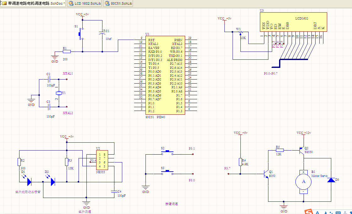

發(fā)一個單片機(jī)紅外測速、調(diào)速程序
查看數(shù): 7101 | 評論數(shù): 5 | 收藏 3
發(fā)布時間: 2015-4-23 13:42
采用80c51單片機(jī)進(jìn)行測速調(diào)速。 nclude <reg51.h> #include <intrins.h> unsigned char code lcd[]={"speed0k"};   unsigned char code table[]= {"0123456789"}; unsigned char cod ...
