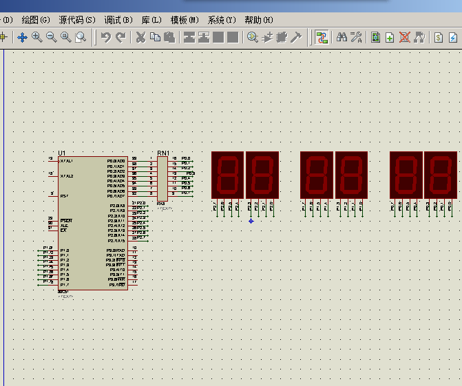

單片機(jī)秒表proteus仿真及源碼
查看數(shù): 2723 | 評論數(shù): 1 | 收藏 0
發(fā)布時(shí)間: 2016-9-28 13:27
源程序: #include<reg51.h> unsigned char t[3]={0,0,0},x[3]; unsigned int a=4000; unsigned char i; main() { TMOD=0x02; TH0=0x06; TL0=0x06; IE=0x82; TR0=1; while(1); } timer0() interrupt 1 ...
