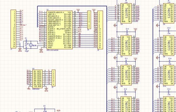

光立方原理圖和PCB及源程序 全套資料下載
查看數(shù): 12251 | 評論數(shù): 10 | 收藏 9
發(fā)布時間: 2016-10-20 20:00
源程序: /*Ideasoft http://2013mcu.taobao.com/ edition:v1 Display memery:display[8][8]; */ #include "reg52.h" #define uchar unsigned char #define uint unsigned int uchar xdata display[8][8]; ...

用的是什么mcu

光立方呼吸燈程序
  1. #include<reg52.h>
  2. #define uint unsigned int
  4.
  5. int i=0;
  6. uchar code table[]={
  7. 0,0,1,2,3,4,5,6,7,8,9,10,
  8. 11,12,13,14,15,16,17,18,
  9. 19,20,21,22,23,24,25,26,27,
  10. 28,29,30,31,32,33,34,35,36,
  11. 37,38,39,40,41,42,43,44,45,
  12. 46,47,48,49,50,51,52,53,54,
  13. 55,56,57,58,59,60,61,62,63,
  14. 64,65,66,67,68,69,70,71,72,
  15. 73,74,75,76,77,78,79,80,81,82,
  16. 83,84,85,86,87,88,89,90,91,
  17. 92,93,94,95,96,97,98,99,100,101,102,103,104,105,106,107,108,109,
  18. 110,111,112,113,114,115,116,117,118,119,120,121,122,123,124};
  19. void delay(uint z)
  20. {
  21.         uint x,y;
  22.         for(x=15;x>0;x--)
  23.         for(y=z;y>0;y--);
  24. }
  25. void light1(uchar num1)
  26. {
  27.         uchar j;
  28.         P2=0xff;
  29.         P1=0x00;
  30.         P2=0x00;
  31.         j = table[num1];
  32.         delay(j);
  33.         P2=0xff;
  34.         P1=0xff;
  35.         P2=0x00;
  36.         delay(126-j);
  37. }
  38. void light2(uchar num2)
  39. {
  40.         uchar j;
  41.         P2=0xff;
  42.         P1=0xff;
  43.         P2=0x00;
