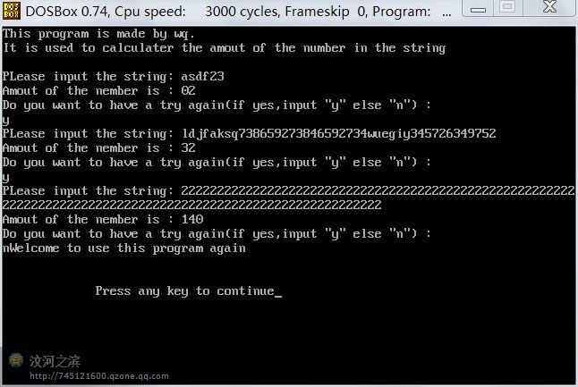

;This is made by wq
;編程從鍵盤讀入不超過256個字符的字符串;
;編程統(tǒng)計其中數(shù)字的個數(shù),并將結(jié)果在屏幕上輸出。
;經(jīng)進(jìn)一步完善(能輸出三位數(shù)啦)

over:                   ;處理并輸出數(shù)字個數(shù)
   lea dx,overs
   mov ah,09h
   int 21h
  mov ax,0000h
  mov al,sum[0]         ;判斷是否為三位數(shù)
  cmp al,64h
  jae san
  mov bl,10
  div bl
  mov dx,ax
  add dx,3030h
   mov ah,02h
   int 21h
   mov dl,dh
   mov ah,02h
    int 21h
    jmp a
san: mov bl,10          ;如果是三位數(shù)則多處理一位
     div bl
     mov cl,ah          ;把第一位給cl
     add cl,30h
     mov ah,00h
     div bl              ;第二次除十
     mov dx,ax
     add dx,3030h
     mov ah,02h
     int 21h
     mov dl,dh
     mov ah,02h
     int 21h
     mov dl,cl
     mov ah,02h
     int 21h
a:  lea dx,kongzi
    mov ah,09h            ;判斷是否循環(huán)操作
    int 21h
    lea dx,tital2
    mov ah,09h
    int 21h
    mov ah,01h
    int 21h
    cmp al,'y'
    je main
    lea dx,tital3
    mov ah,09h
    int 21h
    MOV AH,4CH
    INT 21H
