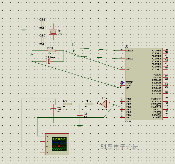

stc12c5a60s2單片機程序包SPWM波形輸出程序

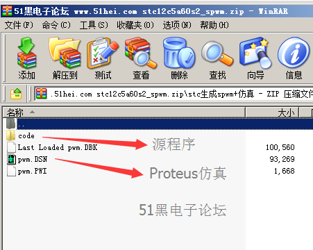

所有資料51hei提供下載:
stc12c5a60s2_spwm.zip (70.75 KB, 下載次數(shù): 266)
