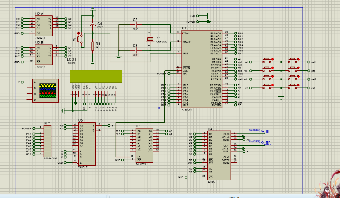

求大神幫我看看仿真結(jié)果不對問題出在哪里,萬分感謝
ID:308857 發(fā)表于 2018-5-23 10:52 | 只看該作者 |只看大圖 回帖獎勵 |倒序瀏覽 |閱讀模式
仿真結(jié)果應(yīng)該是,顯示屏顯示的數(shù)字頻率,和示波器周期算出來的頻率差不多誤差較小。但是我現(xiàn)在仿真出來以后誤差特別大,示波器顯示的周期基本就在8.6變化,不管是1hz還是10000hz。程序在附件,或者我貼到下面

void produce()/*掃頻產(chǎn)生程序*/
                n3=sett1*100000+sett2*10000+sett3*1000+sett4*100+sett5*10+sett6;
                        if(flag1==1&flag2==1)/*使用定時器0*/
                                a1=0;b1=0;c1=0;
                                n2=low;
                                while(n2<high)
                                        n1=50000/n2;
                                        c=n1;
                                        chuzhi();
                                        COM0=h;
                                        COM0=e;
                                        ET0=1;
                                        TR0=1;
                                        display1(n2);
                                        while(n<50)
                                                keyscan();
                                        n=0;
                                        ET0=0;
                                        TR0=0;
                                        n2=n2+n3;
                                        if(star==0)
                                        break;
                                n2=high;
                                while(n2>low)
                                        n1=50000/n2;
                                        c=n1;
                                        chuzhi();
                                        COM0=h;
                                        COM0=e;
                                        ET0=1;
                                        TR0=1;
                                        display1(n2);
                                        while(n<50)
                                                keyscan();
                                        n=0;
                                        ET0=0;
                                        TR0=0;
                                        n2=n2-n3;
                                        if(star==0)
                                        break;
                        if(flag1==2&flag2==2)/*使用定時器1*/
                                a1=1;b1=0;c1=0;
                                n2=low;
                                while(n2<high)
                                        n1=1000000/n2;
                                        c=n1;
                                        chuzhi();
                                        COM1=h;
                                        COM1=e;
                                        ET0=1;
                                        TR0=1;
                                        display1(n2);
                                        while(n<50)
                                                keyscan();
                                        n=0;
                                        ET0=0;
                                        TR0=0;
                                        n2=n2+n3;
                                        if(star==0)
                                        break;
                                n2=high;
                                while(n2>low)
                                        n1=1000000/n2;
                                        c=n1;
                                        chuzhi();
                                        COM1=h;
                                        COM1=e;
                                        ET0=1;
                                        TR0=1;
                                        display1(n2);
                                        while(n<50)
                                                keyscan();
                                        n=0;
                                        ET0=0;
                                        TR0=0;
                                        n2=n2-n3;
                                        if(star==0)
                                        break;
                                if(flag1==1&flag2==2)/*先使用定時器0,再使用定時器1*/
                                        a1=0;b1=0;c1=0;
                                        n2=low;
                                        while(n2<5000)
                                                n1=50000/n2;
                                                c=n1;
                                                chuzhi();
                                                COM0=h;
                                                COM0=e;
                                                ET0=1;
                                                TR0=1;
                                                display1(n2);
                                                while(n<50)
                                                        keyscan();
                                                n=0;
                                                ET0=0;
                                                TR0=0;
                                                n2=n2+n3;
                                                if(star==0)
                                                break;
                                        a1=1;b1=0;c1=0;
                                        while(n2<high)
                                                n1=1000000/n2;
                                                c=n1;
                                                chuzhi();
                                                COM1=h;
                                                COM1=e;
                                                ET0=1;
                                                TR0=1;
                                                display1(n2);
                                                while(n<50)
                                                        keyscan();
                                                n=0;
                                                ET0=0;
                                                TR0=0;
                                                n2=n2+n3;
                                                if(star==0)
                                                break;
                                        n2=high;
                                        while(n2>low)
                                                n1=1000000/n2;
                                                c=n1;
                                                chuzhi();
                                                COM1=h;
                                                COM1=e;
                                                ET0=1;
                                                TR0=1;
                                                display1(n2);
                                                while(n<50)
                                                {keyscan();}
                                                n=0;
                                                ET0=0;
                                                TR0=0;
                                                n2=n2-n3;
                                                if(star==0)
                                                break;
                                        a1=0;b1=0;c1=0;
                                        while(n2>low)
                                                n1=50000/n2;
                                                c=n1;
                                                chuzhi();
                                                COM0=h;
                                                COM0=e;
                                                ET0=1;
                                                TR0=1;
                                                display1(n2);
                                                while(n<50)
                                                {keyscan();}
                                                n=0;
                                                ET0=0;
                                                TR0=0;
                                                n2=n2-n3;
                                                if(star==0)
                                                break;
void main()
        COM8253=0x36;/*8253初始化,選擇定時器0,工作方式3,二進制*/
        COM8253=0x76;/*選擇定時器1,工作方式3,二進制*/
        init();/*1602初始化*/
        display();/*頻率顯示界面*/
        TMOD=0x01;/*定時器0工作方式1*/
        TH0=(65536-50000)/256;/*定時器0初值裝入*/
        TL0=(65536-50000)%256;
        EA=1;/*開總中斷*/
        ET0=0;/*允許定時器0中斷*/
        TR0=0;/*允許定時器計數(shù)*/
        a1=0;b1=0;c1=0;
        while(1)
                keyscan();
                setlow(set1,set2,set3,set4,set5,set6,set11,set22,set33,set44,set55,set66);
                if(star==1)
                produce();
void T0_time() interrupt 1/*使定時器中斷0*/
        n++;
