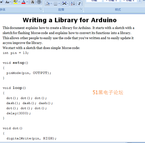

Arduino Libraries庫(kù)函數(shù)大全
Libraries
目錄
Libraries provide extra functionality for use in sketches, e.g. working with hardware or manipulating data. To use a library in a sketch, select it from Sketch > Import Library.
Standard Libraries
•    EEPROM - reading and writing to "permanent" storage
•    Ethernet - for connecting to the internet using the Arduino Ethernet Shield
•    Firmata - for communicating with applications on the computer using a standard serial protocol.
•    LiquidCrystal - for controlling liquid crystal displays (LCDs)
•    SD - for reading and writing SD cards
•    Servo - for controlling servo motors
•    SPI - for communicating with devices using the Serial Peripheral Interface (SPI) Bus
•    SoftwareSerial - for serial communication on any digital pins. Version 1.0 and later of Arduino incorporate Mikal Hart's NewSoftSerial library as SoftwareSerial.
•    Stepper - for controlling stepper motors
•    WiFi - for connecting to the internet using the Arduino WiFi shield
•    Wire - Two Wire Interface (TWI/I2C) for sending and receiving data over a net of devices or sensors.
The Matrix and Sprite libraries are no longer part of the core distribution.
完整的Word格式文檔51黑下載地址:
Arduino Libraries庫(kù)函數(shù)大全(官方網(wǎng)站).doc (3 MB, 下載次數(shù): 62)
