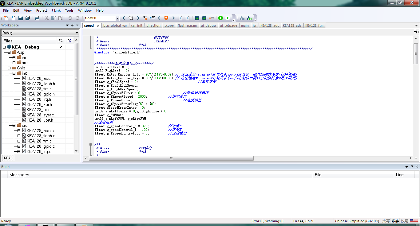

#include  "includefile.h"
/**********全局變量定義********/
int32 LeftDead = 0;
int32 RighDead = 0;
float Ratio_Encoder_Left = 207/(1175*0.02);// 左輪速度=counter*左輪周長(mm)/(左輪轉一圈對應的脈沖數(shù)*程序周期)
float Ratio_Encoder_Righ = 207/(1175*0.02);// 右輪速度=counter*右輪周長(mm)/(右輪轉一圈對應的脈沖數(shù)*程序周期)
float g_fRealSpeed = 0;                                //真實速度
float g_fLeftRealSpeed;
float g_fRighRealSpeed;
float g_fSpeedFilter = 0;                        //階梯濾波速度
float g_fExpectSpeed = 2800;                //期望速度
float g_fSpeedError;                                //速度偏差
float g_fSpeedErrorTemp[5] = {0};
float fSpeedErrorInteg = 0;
int32 g_nLeftpulse = 0,g_nRighpulse = 0;
float g_PWMOut;
int32 g_nLeftPWM, g_nRighPWM;
//速度控制
float g_speedControl_P = 320;                //速度P
float g_speedControl_I = 100;                //速度I
float g_fSpeedControlOut = 0;                //速度輸出
