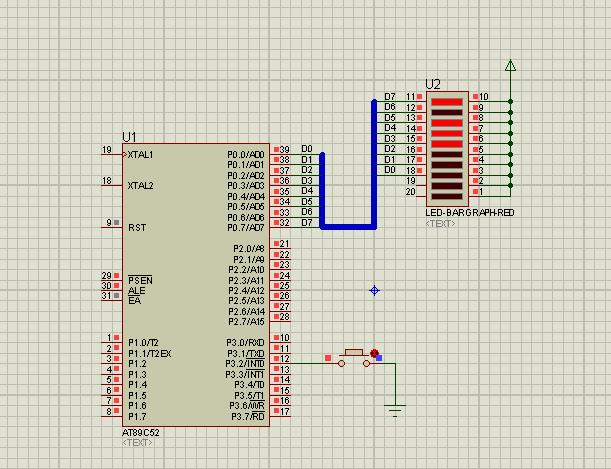

這幾天犯糊涂,一不小心三天用掉近300黑幣,現(xiàn)在只好當(dāng)楊白勞了。出賣以前的一個算盤式數(shù)碼管顯示的程序,博大家一笑!
Proteus仿真及源程序在附件中

奉上源代碼:
#include <REG52.H>
void Delay(unsigned int count)
        unsigned int i,j;
        for(i=0;i<count;i++)
        for(j=0;j<0;j++);
main()
unsigned char code Tab[]={0xff,0xdf,0xcf,0xc7,0xc3,0x7f,0x5f,0x4f,0x47,0x43};
unsigned char *p[ ]={&Tab[0],&Tab[1],&Tab[2],&Tab[3],&Tab[4],&Tab[5],&Tab[6],&Tab[7],&Tab[8],&Tab[9]};
unsigned char i;      //定義無符號字符型數(shù)據(jù)
while(1)
for(i=0;i<=9;i++)
P0=*p[i];
Delay(100000);
ID:66287 發(fā)表于 2018-7-31 10:43 | 顯示全部樓層
