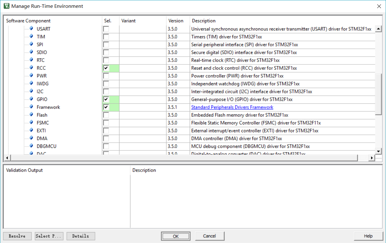

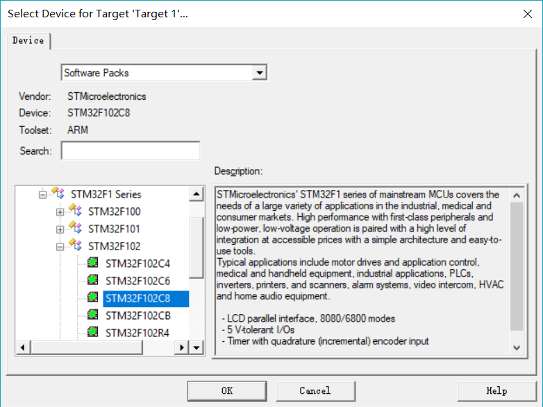

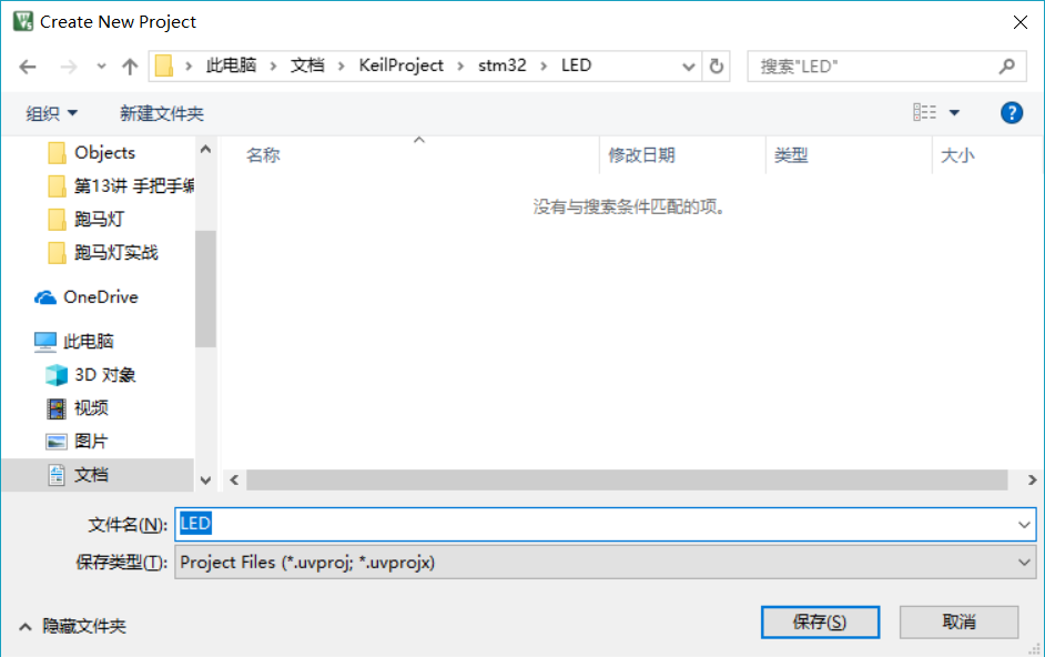

新建一個工程取名為LED
#include "stm32f10x_gpio.h"
#include "stm32f10x_rcc.h"
void delay(int num)
                int i;
                for(;num>0;num--)
                        for(i=5000;i>0;i--);
int main()
                RCC_APB2PeriphClockCmd(RCC_APB2Periph_GPIOB,ENABLE);                        //打開GPIOB時鐘
                GPIO_InitTypeDef GPIO_InitTypeStruct;                                                                                        //創(chuàng)建GPIO初始化結構體
                GPIO_InitTypeStruct.GPIO_Mode = GPIO_Mode_Out_PP;                                        //  *
                GPIO_InitTypeStruct.GPIO_Pin = GPIO_Pin_12;                                                                //  *
                GPIO_InitTypeStruct.GPIO_Speed = GPIO_Speed_50MHz;                                //設置GPIO初始化必要參數(shù)
                GPIO_Init(GPIOB,&GPIO_InitTypeStruct);                                                                                //進行GPIO初始化,選擇GPIOB.12引腳
                while(1)
                                GPIO_ResetBits(GPIOB,GPIO_Pin_12);                                                                                //LED亮滅實驗
                                delay(1000);
                                GPIO_SetBits(GPIOB,GPIO_Pin_12);
                                delay(1000);

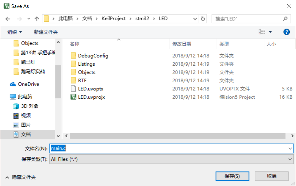

取名
取名
