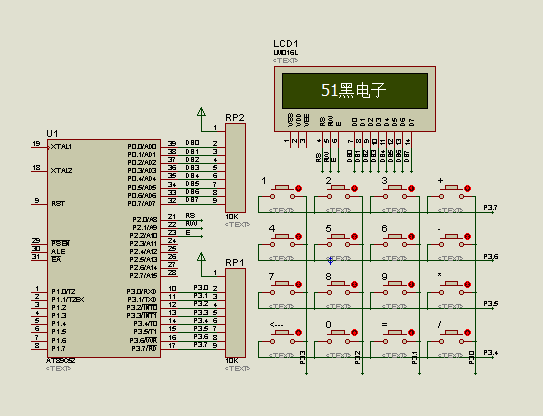

單片機源程序如下:
  1. #include "reg52.h"
  2. #include "string.h"
  3. #include "stdio.h"
  4. #include "lcd1602.h"
  5. #include "keyboard.h"
  6. #define keydeng                14
  7. #define keyzuoyi  12
  8. code unsigned char KeyDisPlaybuf[16] =
  9. {
  10.     '1', '2', '3', '+',\
  11.     '4', '5', '6', '-',\
  12.     '7', '8', '9', '*',\
  13.     '<', '0', '=', '/'
  14. };
  15. long Count(char *ch, char len)//簡單計算器 僅支持+-*/
  16. {
  17.     unsigned char i = 0;
  18.     char Operation;
  19.     long Num1=0,Num2=0;
  20.     while(i<len && ch[i]!='+' && ch[i]!='-' && ch[i]!='*' && ch[i]!='/')
  21.     {
  22.         Num1*=10;
  23.         Num1+=ch[i]-'0';
  24.         i++;
  25.     }
  26.     Operation=ch[i++];
  27.     while(i<len && ch[i]!='=')
  28.     {
  29.         Num2*=10;
  30.         Num2+=ch[i]-'0';
  31.         i++;
  32.     }
  33.     switch(Operation)
  34.     {
  35.         case'+':return Num1+Num2;
  36.         case'-':return Num1-Num2;
  37.         case'*':return Num1*Num2;
  38.         case'/':return Num1/Num2;
  39.     }
  40.         return 0;
  41. }
  42. void EasyCounter(void)
  43. {
  44.         unsigned char buff[30];
  45.         unsigned char text[30];
  46.         unsigned char key;
  47.         unsigned char i = 0;
  48.         do
  49.   {
  50.                         key = keycan();//讀取鍵值
  51.                         if(key!=0xff)//鍵值不等于0
  52.                         {
  53.                                 text[i++]=KeyDisPlaybuf[key];//記錄鍵值對應的字符
  54.                                 text[i]='\0';
  55.         LCD_ShowStr(0,0,"                ");
  56.                                 LCD_ShowStr(16-strlen(text),0,text);
  57.                         }
  58.         if(key==keyzuoyi&&i>0)//按下"<"時刪除一位
  59.           i-=2;
  60.         }while(key!=keydeng);//按下'='時結束輸入
  61.         sprintf(buff, "%ld", Count(text, strlen(text)));
  62.   LCD_ShowStr(0,1,"                ");
  63.         LCD_ShowStr(16-strlen(buff),1,buff);
  64. }
  65. void main(void)
  66. {
  67.   LCD_Init();
  68.   while(1)
  69.   {
  70.     EasyCounter();
  71.   }
  72. }
復制代碼

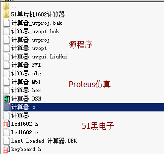

所有資料51hei提供下載:
51單片機1602計算器.zip (63.16 KB, 下載次數(shù): 38)
