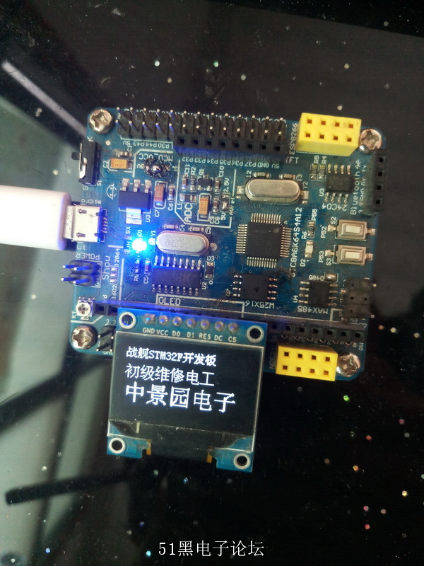

單片機(jī)型號(hào)STC8A8K64S4A12,字庫(kù)芯片W25Q128(用原子戰(zhàn)艦的板子把字庫(kù)寫(xiě)到w25q128里面),OLED是0.96寸SPI接口的。
程序根據(jù)原子的OLED實(shí)驗(yàn)和漢字顯示實(shí)驗(yàn)修改的,可以顯示12,16,24的字符和漢字。
oled接線(xiàn):
sbit OLED_CS  = P0^3;
sbit OLED_RS  = P0^4;
sbit OLED_RST = P0^5;
sbit OLED_SDIN = P0^6;
sbit OLED_SCLK = P0^7;
W25Q128接線(xiàn):
cs接P2^2
mosi接P2^3
miso接P2^4
clk接P2^5

        Show_Str(0,0,128,16,"戰(zhàn)艦STM32F開(kāi)發(fā)板",12,0);
        Show_Str(0,18,128,16,"初級(jí)維修電工",16,0);
        Show_Str(0,36,128,24,"中景園電子",24,0);
        OLED_Refresh_Gram();        //更新顯示到OLED
