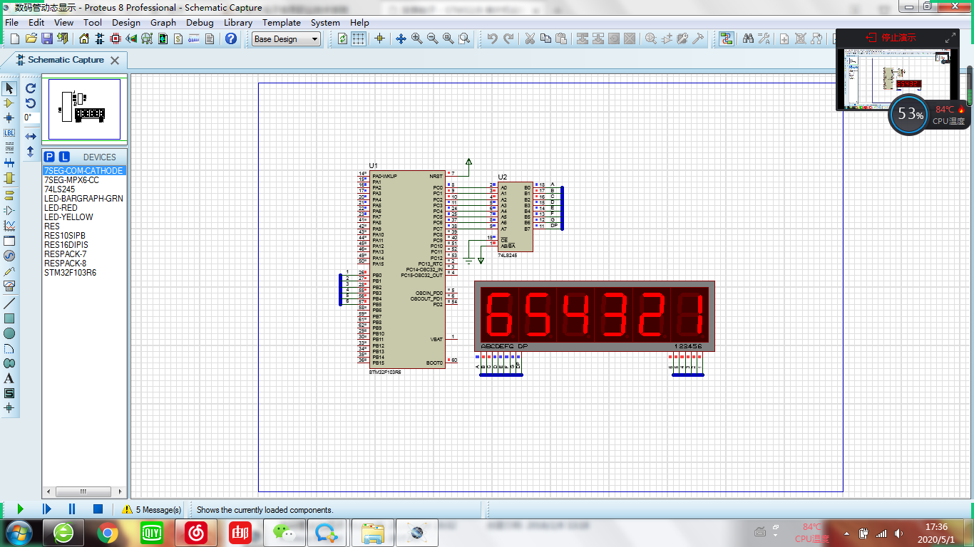

STM32數(shù)碼管動態(tài)顯示Proteus仿真程序
ID:740717 發(fā)表于 2020-5-1 17:38 | 顯示全部樓層 |閱讀模式
希望可以幫到你
單片機(jī)源程序如下:
  1. #include "stm32f10x.h"
  2. #include "smg.h"
  3. void SMG_Init(void)
  4. {
  5.         GPIO_InitTypeDef  GPIO_InitStructure;
  6. //使能GPIOC時(shí)鐘
  7.         RCC_APB2PeriphClockCmd(RCC_APB2Periph_GPIOB|RCC_APB2Periph_GPIOC,
  8. ENABLE);
  9.         GPIO_InitStructure.GPIO_Pin = 0x00ff;                                        //PC0-PC7引腳配置
  10.         GPIO_InitStructure.GPIO_Mode = GPIO_Mode_Out_PP;   //配置為推挽輸出
  11.         GPIO_InitStructure.GPIO_Speed = GPIO_Speed_50MHz;   //GPIOC速度為50MHz
  12. GPIO_Init(GPIOC, &GPIO_InitStructure);                                //初始化PC0-PC7
  13. GPIO_InitStructure.GPIO_Pin = 0x003f;                                        //PB0-PC5引腳配置
  14.         GPIO_InitStructure.GPIO_Mode = GPIO_Mode_Out_PP;   //配置為推挽輸出
  15.         GPIO_InitStructure.GPIO_Speed = GPIO_Speed_50MHz;   //GPIOB速度為50MHz
  16. GPIO_Init(GPIOB, &GPIO_InitStructure);                                //初始化PB0-PB5
  17. }
