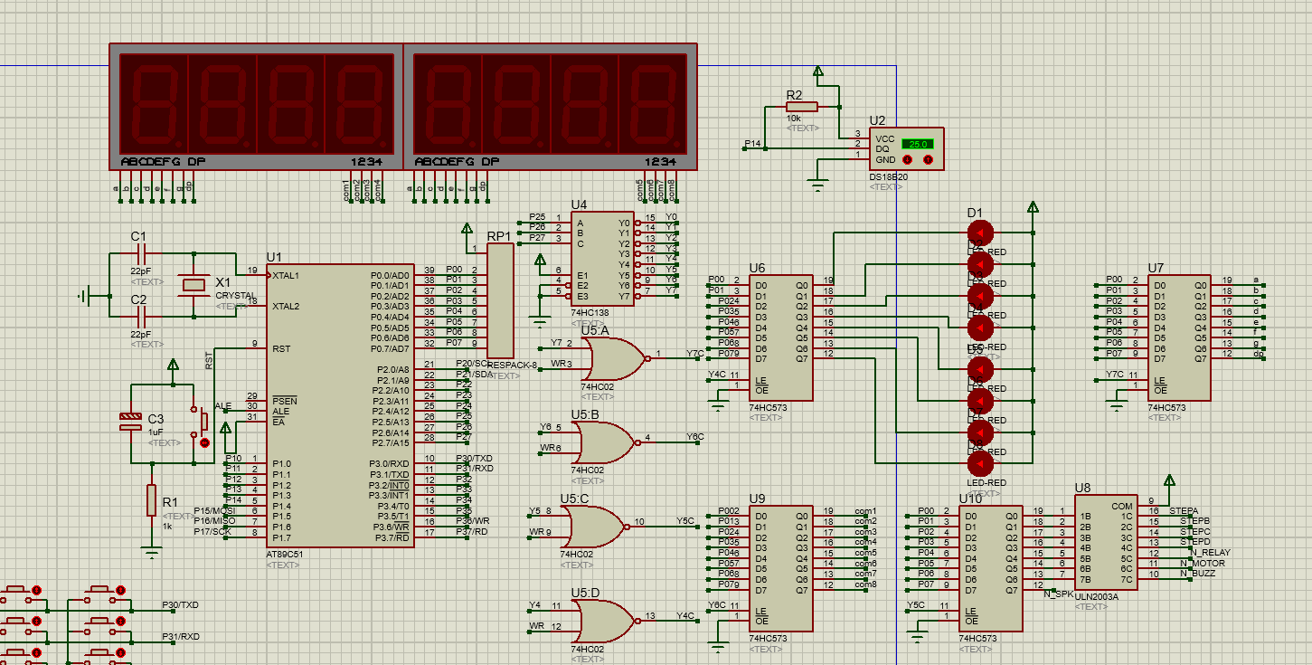

想實(shí)現(xiàn)單片機(jī)100-0循環(huán),不知道錯(cuò)在哪里?附原理圖
ID:744168 發(fā)表于 2020-5-4 21:15 | 顯示全部樓層 |閱讀模式
本帖最后由 飛魚(yú)seraet 于 2020-5-5 21:11 編輯
#include<reg52.h>
unsigned char code DuanMa[16]={0xc0,0xf9,0xa4,0xb0,0x99,0x92,0x82,0xf8,0x80,0x90,0x88,0x80,0xc6,0xc0,0x86,0x8e,};
unsigned char number;
void Delay(unsigned int t)
  while(t--);
void DisplaySMG(unsigned char dat,unsigned char pos)
  P2=(P2&0x1f)|0xc0;
  P0=0x01<<pos;
  P2=(P2&0x1f)|0xe0;
  P0=dat;
void dynamic()
  DisplaySMG(DuanMa[number/100],1);
  Delay(200);
  DisplaySMG(DuanMa[number%100/10],2);
  Delay(200);
  DisplaySMG(DuanMa[number%10],3);
  Delay(200);
void delay2(unsigned char t)
  while(t--);
   dynamic();
void main()
{   number=0x64;
   while(1)
        Delay(200);
        dynamic();
          number--;
    if(number=0)
    number=100;
    delay2(60);
