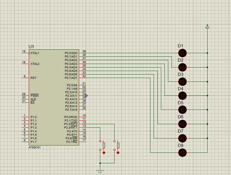

速度可調(diào)流水燈控制,不知道為什么加快速度那里會卡住
ID:847172 發(fā)表于 2020-11-22 10:01 | 顯示全部樓層 |閱讀模式
#include<reg52.h>
typedef unsigned int uint;
typedef unsigned char uchar;
sbit K1=P3^2;
sbit K2=P3^3;
uint t=0;
uint a=101;
uint x=0;
uint display[8]={0xfe,0xfd,0xfb,0xf7,0xef,0xdf,0xbf,0x7f};
uint flag=0;
void delay(int ms){
    uint i;
        while(ms--){
        for(i=0;i<120;i++);
void Init(){
            EA = 1;
         TMOD = 0x10;
         TH1 = (65536-500)/256;
         TL1 = (65536-500)%256;
         ET1 = 1;
         TR1 = 1;
void ZQ() interrupt 3{
         TF1=0;
         TH1 = (65536-1000)/256;
         TL1 = (65536-1000)%256;
         t++;
           if(K1==0){
                 delay(2);//消抖
                if(K1==0)  {a=a-50;  if(a<0)a=1;P0=0x00;delay(2);t=0;}//減速
           if(K2==0){
            delay(2);
                if(K2==0)  {a=a+50;P0=0x00;delay(2);t=0;}//加速
         if(t>=a){
          P0=display[x];
          x++;
          if(x>7){x=0;}
          t=0;
void main(){
     Init();
        while(1);
拜托大家?guī)兔聪履睦镉袉栴}
ID:847172 發(fā)表于 2020-11-22 10:28 | 顯示全部樓層
ID:213173 發(fā)表于 2020-11-22 10:56 | 顯示全部樓層
Ashinchen123452 發(fā)表于 2020-11-22 10:01
拜托大家?guī)兔聪履睦镉袉栴}
按鍵程序含2ms延時程序放在1ms中斷程序中能正常嗎?
