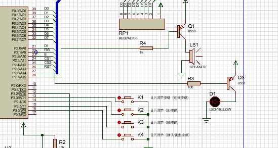

51單片機做的萬年歷,要將鬧鐘報警函數(shù)改下,要求添加一個LED燈,使其在鬧鐘響起前由暗慢慢變亮,當(dāng)鬧鐘響時最亮(需要有個變亮的過程)。

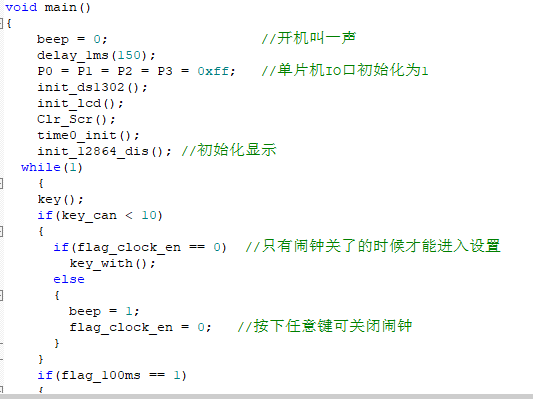

這是程序您可以幫我看看嗎

  307.                 {
  308.                         if(key_can == 2)
  309.                                 set_ds1302time(1,&week,0x8);
  310.                         if(key_can == 3)
  311.                                 set_ds1302time(0,&week,0x8);
  312.                 }
  313.                 if(menu_1 == 8)
  314.                 {
  315.                         if(key_can == 2)
  316.                                 set_ds1302time(1,&shi1,0x24);
  317.                         if(key_can == 3)
  318.                                 set_ds1302time(0,&shi1,0x24);
  319.                         clock1_save();
  320.                 }
  321.                 if(menu_1 == 9)
  322.                 {
  323.                         if(key_can == 2)
  324.                                 set_ds1302time(1,&fen1,0x60);
  325.                         if(key_can == 3)
  326.                                 set_ds1302time(0,&fen1,0x60);
  327.                         clock1_save();
  328.                 }
  329.                 if(menu_1 == 10)
  330.                 {
  331.                         if((key_can == 2) || (key_can == 3))
  332.                                 flag_clock_kai ++;
  333.                         if(flag_clock_kai >= 2)
  334.                                 flag_clock_kai = 0;
  335.                         if(flag_clock_kai == 1)
  336.                                 write_yhanzi_fanbai(1,6,2*16,qita[10],1);
  337.                         else
  338.                                 write_yhanzi_fanbai(1,6,2*16,qita[11],1);
  339.                         clock1_save();
  340.                 }
  341.                  dis_shijian_set();
  342.                 switch(menu_1)
  343.                 {
  344.                         case 1:  write_shu16(0*2,2*8,nian,1);  break;
  345.                         case 2:  write_shu16(0*2,6*8,yue,1);         break;
  346.                         case 3:  write_shu16(0*2,10*8,ri,1);  break;
  347.                         case 4:  write_shu16(1*2,2*8,shi,1);  break;
  348.                         case 5:  write_shu16(1*2,6*8,fen,1);          break;
  349.                         case 6:  write_shu16(1*2,10*8,miao,1);  break;
  350.                         case 7:
  351.                         if(week>0)
  352.                         {
  353.                          write_shu16(2*2,10*8,week-1,1);
  354.                         }
  355.                         if(week<=0)
  356.                         {
  357.                          week=7;
  358.                          write_shu16(2*2,10*8,week-1,1);
  359.                         }
  360.                          break;
  361.                         case 8:  write_shu16(3*2,8*8,shi1,1);  break;
  362.                         case 9:  write_shu16(3*2,12*8,fen1,1); break;
  363.                         case 10: if(flag_clock_kai == 1)
  364.                                         write_yhanzi_fanbai(1,6,2*16,qita[10],1);
  365.                                         else
  366.                                         write_yhanzi_fanbai(1,6,2*16,qita[11],1);
  367.                                          break;
  368.                 }
  369.                 write_time();
  370.         }
  371. }
  372. void menu_dis()
  373. {
  374.         if(menu_1 == 0)
  375.         if(flag_clock_kai == 1)
  376.         {
  377.                 if((fen == fen1) && (shi == shi1) && (miao == 0))
  378.                 {
  379.                         flag_clock_en = 1;
  380.                 }
  381.                 if(flag_clock_en == 1)
  382.                          {
  383.                                  beep=~beep;
  384.                          }
  385.         }
  386. }
  387. //void deng
  388. /
  389. /
  390. void time0_init()
  391. {
  392.         EA  = 1;
  393.         TMOD = 0X11;
  394.         ET0 = 1;
  395.         TR0 = 1;
  396. }
  397. void main()
  398. {
  399.                 beep = 0;
  400.                 delay_1ms(150);
  401.                 P0 = P1 = P2 = P3 = 0xff;
  402.                 init_ds1302();
  403.                 init_lcd();
  404.                 Clr_Scr();
  405.                 time0_init();
  406.                 init_12864_dis();
  407.         while(1)
  408.     {
  409.                 key();
  410.                 if(key_can < 10)
  411.                 {
  412.                         if(flag_clock_en == 0)
  413.                                 key_with();
  414.                         else
  415.                         {
  416.                                 beep = 1;
  417.                                 flag_clock_en = 0;
  418.                         }
  419.                 }
  420.                 if(flag_100ms == 1)
  421.                 {
  422.                         menu_dis();
  423.                         flag_100ms = 0;
  424.                 }
  425.                  if(flag_200ms == 1)
  426.                 {
  427.                         flag_200ms = 0;
  428.                         temperature = read_temp();
  429.                         ds1302_dis();
  430.                 }
  431.         }
  432. }
  433. void time0_int() interrupt 1
  434. {
  435.         static uchar value;
  436.         TH0 = 0x3c;
  437.         TL0 = 0xb0;
  438.         value ++;
  439.         if(value % 2 == 0)
  440.         {
  441.                 flag_100ms = 1;
  442.         }
  443.         if(value % 20 == 0)
  444.         {
  445.                 flag_200ms = 1;
  446.         }
  447. }
ID:230742 發(fā)表于 2021-5-4 20:57 | 顯示全部樓層
單獨寫一個呼吸燈的函數(shù)
呼吸燈()
然后在鬧鐘的BEEP前先調(diào)用這個函數(shù),燈亮了,鬧鐘也響了。
響完關(guān)閉燈光。
