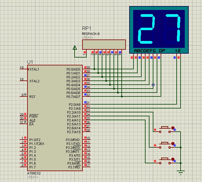

ID:213173 發(fā)表于 2022-4-28 20:56 | 顯示全部樓層
  1. #include <REG51.H>
  2. sbit W1=P2^0;//十位
  3. sbit W2=P2^1;//個(gè)位
  4. sbit S1=P2^2;//++
  5. sbit S2=P2^3;//--
  6. sbit S3=P2^4;//清0
  7. unsigned char code table[]={//共陰數(shù)碼管段碼"0~f-."
  8.                 0x3f,0x06,0x5b,0x4f,
  9.                 0x66,0x6d,0x7d,0x07,
  10.                 0x7f,0x6f,0x77,0x7c,
  11.                 0x39,0x5e,0x79,0x71,0x40,0x80};
  12. void Delay(unsigned t)
  13. {
  14.         unsigned i,j;
  15.         for(i=t;i>0;i--)
  16.                 for(j=120;j>0;j--);
  17. }
  18. void main()
  19. {
  20.         unsigned char num=0;
  21.         unsigned char count=0;
  22.         bit sign=0;
  23.         bit flag=0;
  24.         while(1)
  25.         {
  26.                 if(!S1||!S2||!S3)
  27.                 {
  28.                         if(++count>=10 && sign==0)
  29.                         {
  30.                                 sign=1;
  31.                                 if(!S1){if(num<99)num++;}
  32.                                 if(!S2){if(num>0)num--;}
  33.                                 if(!S3)num=0;
  34.                         }
  35.                 }
  36.                 else{count=0;sign=0;}
  37.                 if(flag)
  38.                 {
  39.                         W1=1;W2=1;
  40.                         P0=table[num/10];
  41.                         W1=0;W2=1;flag=0;
  42.                 }
  43.                 else
  44.                 {
  45.                         W1=1;W2=1;
  46.                         P0=table[num%10];
  47.                         W1=1;W2=0;flag=1;
  48.                 }
  49.                 Delay(1);
  50.         }
  51. }
