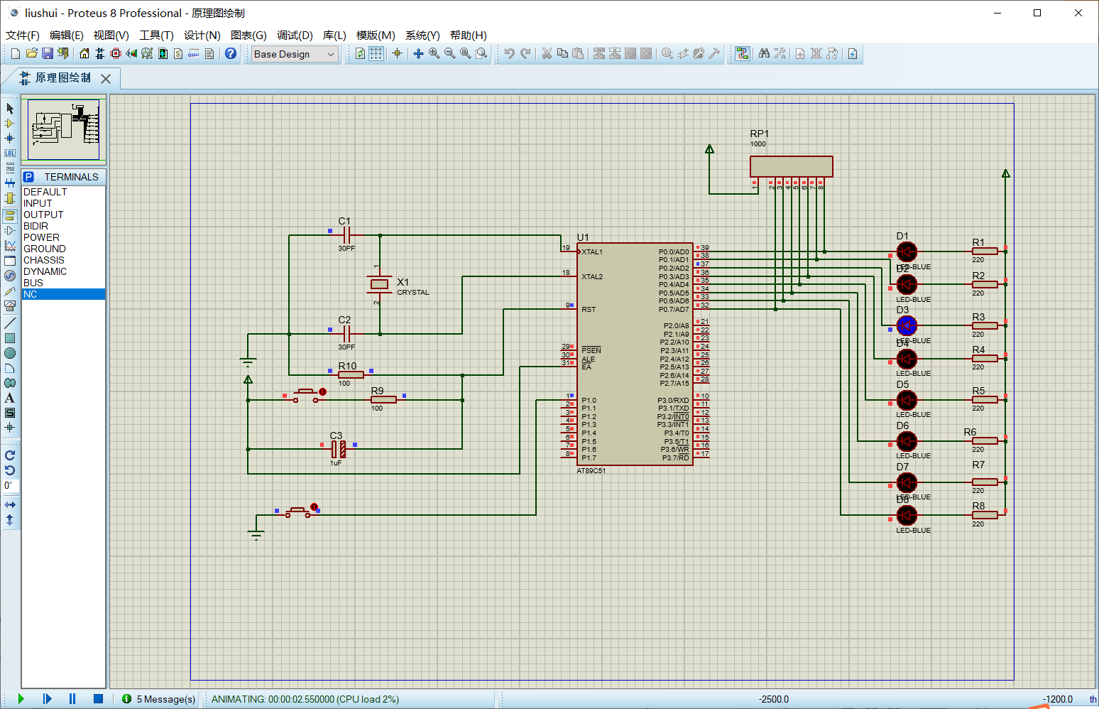

ID:1047409 發(fā)表于 2022-10-12 13:23 | 顯示全部樓層
#include <REGX51.H>
unsigned char k=0;
void delay(unsigned int num)
         unsigned int i,j;
         for(i=0;i<num;i++)
         for(j=0;j<120;j++)
void main()
         unsigned char i,j;
          IT0=1; //ÅäÖÃ′¥·¢·½ê½£¬Ï½μÑØ′¥·¢
          EX0=1;  //ÖD¶ÏÔêDí
          EA=1;  //×ü¿a1Ø
          PX0=0;  //ÖD¶ÏóÅÏè¼¶£¬Ä¬èÏóÅÏè¼¶¿éòÔê¡
          while(1)
                if(k==0)
                                j=0xfe;
                                for(i=0;i<8;i++) //¶¨òåiÎa0~8μÄìõ¼têy£¬jÎaLED1μ½8μÄ
                                        P1=j;
                                        j=(j<<1)|0x01;
                                        delay(300);
                        else
                                        j=0x7f;
                                        for(i=8;i>0;i--)
                                        P1=j;
                                        j=(j>>1)|0x80;
                                        delay(300);
void waib0() interrupt 0  //°′ò»ÏÂè¡·′
        k=~k;
