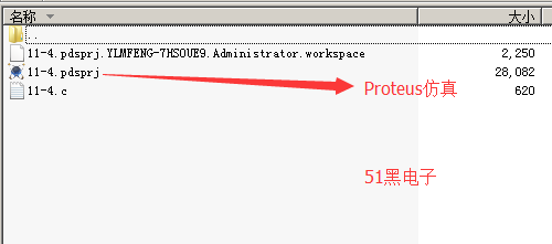

protues仿真
protues仿真

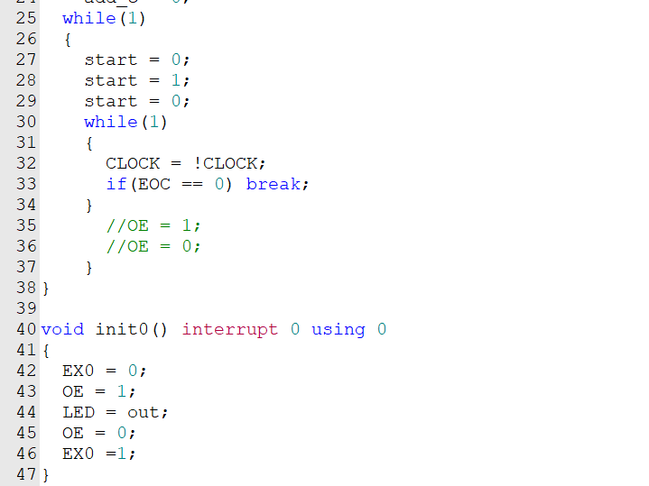

關(guān)鍵部分代碼
關(guān)鍵部分代碼
單片機(jī)源程序如下:
  1. #include <reg51.h>
  2. #include <intrins.h>
  4. #define uint unsigned int
  5. #define LED P0
  6. #define out P1
  7. sbit start = P2^1;
  8. sbit OE = P2^7;
  9. sbit CLOCK = P2^0;
  10. sbit add_a = P2^4;
  11. sbit add_b = P2^5;
  12. sbit add_c = P2^6;
  13. sbit EOC = P3^2;
  14. void main()
  15. {
  16.
  17.                 EA = 1;
  18.                 EX0 = 1;
  19.                 IT0 = 0;
  20.
  21.                 add_a = 0;
  22.                 add_b = 0;
  23.                 add_c = 0;
  24.         while(1)
  25.         {
  26.           start = 0;
  27.                 start = 1;
  28.                 start = 0;
  29.                 while(1)
  30.                 {
  31.                         CLOCK = !CLOCK;
  32.                         if(EOC == 0) break;
  33.                 }
  34.                         //OE = 1;
  35.                         //OE = 0;
  36.                 }
  37. }
  38. void init0() interrupt 0 using 0
  39. {
  40.         EX0 = 0;
  41.         OE = 1;
  42.         LED = out;
  43.         OE = 0;
  44.         EX0 =1;
  45. }
