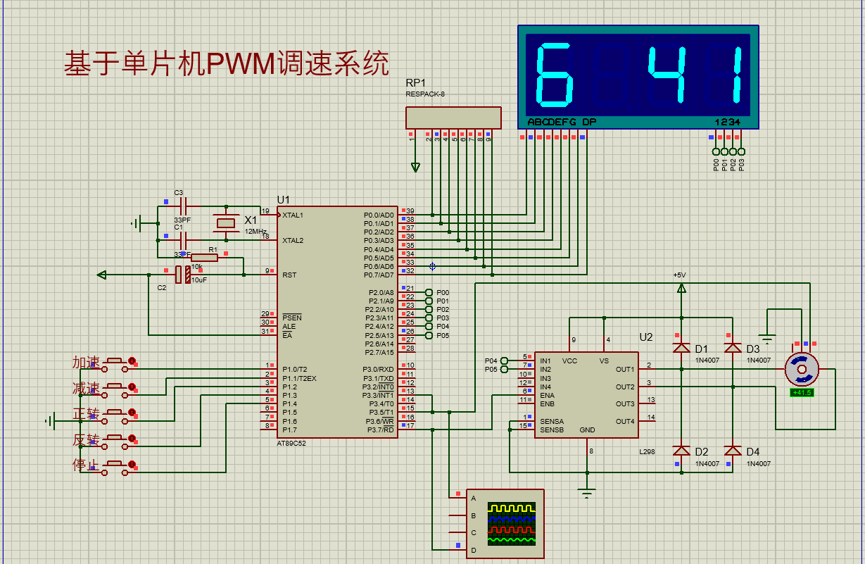

單片機pwm調(diào)速為什么占空比60和70的時候轉(zhuǎn)速沒有變化?還有為什么speed = speed*2.2

部分單片機源碼:
#define uchar unsigned char#define  uint unsigned int
void delay(uint x)           //延時函數(shù)
     uint i,j;
         for(i=x;i>0;i--)
            for(j=0;j<110;j++);   //執(zhí)行110次約為1ms
void SystemInt()  //系統(tǒng)初始化
        TMOD = 0x51;   //T0定時器 T1計數(shù)器  均采用方式1
        TH0 = (65536-250)/256;
        TL0 = (65536-250)%256;           //定時250us
        ET0 = 1; TR0 = 1;                //打開T0
        ET1 = 1;TR1 = 1;                                                         //打開T1
        TH1 = 0;
        TL1 = 0;                          //計數(shù)器初值為0
  EA = 1;                                                                                                         //開啟總中斷
        IN1 = 1;
        IN2 = 0;        //初始正轉(zhuǎn)
void PWMOUT()                   //PWM輸出控制
        if(cnt<PWMTime)           //小于計數(shù)變量,輸出高電平
                PWM=1;
        else
                PWM=0;      //大于計數(shù)變量,低電平
        if(cnt>100)
                cnt=0;
void SetSpeed()     //速度設(shè)定
        if(Add==0)   //速度加
                delay(100);                   //按鍵消抖
                if(Add==0)
                        PWMTime+=10;   //PWM波占空比增加10%
                                dw += 1;       //檔位加1
                                if(dw>9)
                                dw = 9;
                                while(Add==0);   //松手檢測
        if(Sub==0)     //如果速度減
                delay(100);    // 按鍵消抖
                if(Sub==0)
                                PWMTime-=10;    //PWM波占空比減少10%
                                dw -= 1;                                //檔位減1
                                        if(dw<0)
                                dw = 0;
                        while(Sub==0);
        if(zhen==0)     //正轉(zhuǎn)
                delay(100);
                if(zhen==0)
                   IN1 = 1;
                   IN2 = 0;
                   while(zhen==0);
        if(fan==0)   //反轉(zhuǎn)
                delay(100);
                if(fan==0)
                   IN1 = 0;
                   IN2 = 1;
                   while(fan==0);
        if(Stop==0)         //停止
                delay(100);
                if(Stop==0)
                   IN1 = 1;
                   IN2 = 1;
                   while(Stop==0);
void xianshi()                  //數(shù)碼管顯示速度和檔位
        uint shi,ge;
        shi=speed/10;
        ge=speed%10;
    WE1 = 0;
                P0 = table[ge];    //速度個位顯示
                delay(1);
                WE1 = 1;
                WE2 = 0;
                P0 = table[shi];     //速度十位顯示
                delay(1);
                 WE2 = 1;
                WE3 = 1;
                 WE4 = 0;
                P0 = table[dw];      //檔位顯示
                delay(1);
                 WE4 = 1;
void timer0() interrupt 1   //定時器
        TL0 = (65536-250)%256;       //250us一次脈沖
        cnt++;
        time++;
        if(time==4000)              //1s時間內(nèi)T1的脈沖次數(shù) 1除以250us
                time = 0;                  //計數(shù)置0
                TR0 = 0;TR1 = 0;          //先關(guān)閉定時器
                speed = TH1;
                speed = speed << 8;       //左移8位
                speed += TL1;                                                         //賦值
                speed = speed*2.2;                 //電機轉(zhuǎn)一圈產(chǎn)生24個脈沖,轉(zhuǎn)速為speed/24*60 r/min
                TH1 = 0;TL1 = 0;                                                //清0重新計數(shù)
                TR0 = 1;TR1 = 1;                                                //重新啟動定時器
