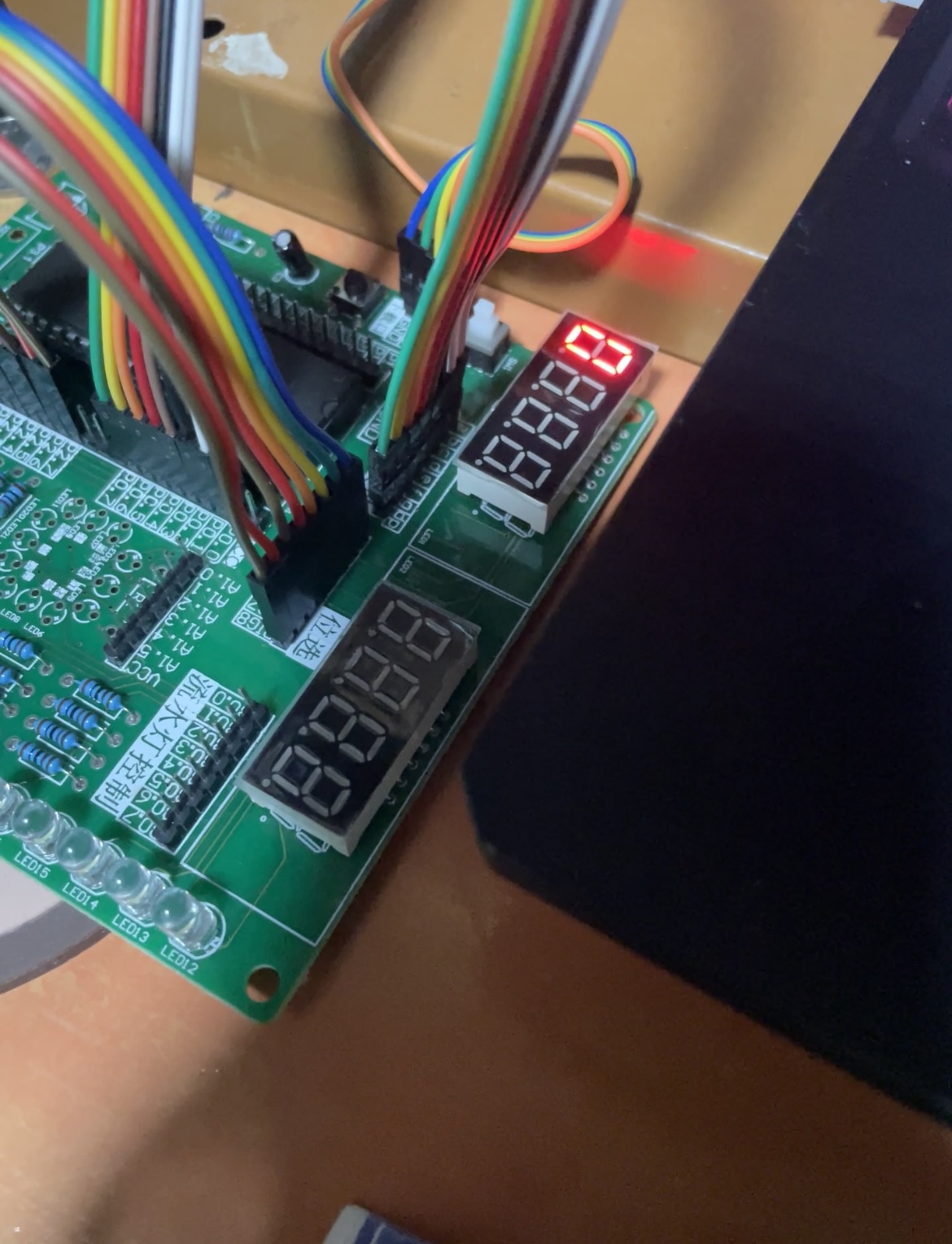

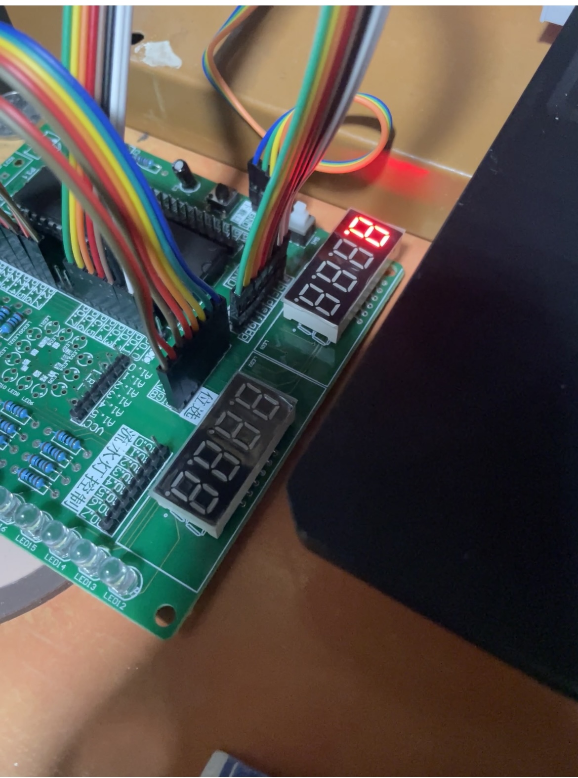

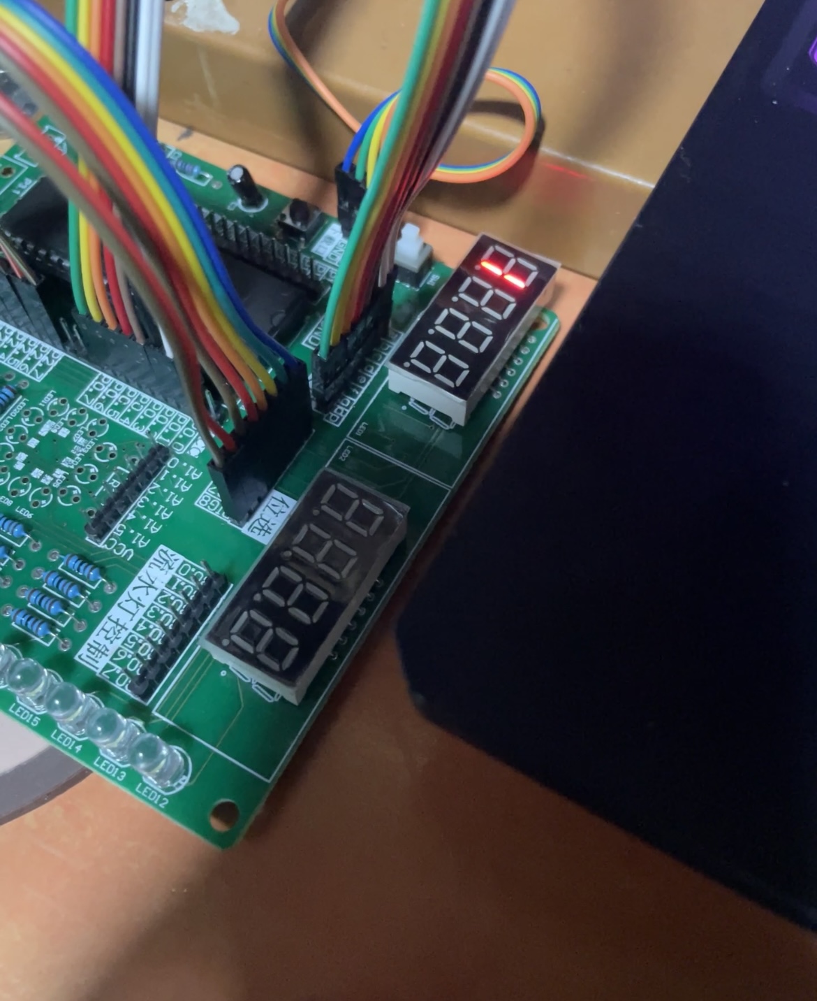

為什么動態(tài)顯示完后只顯示8.
#include"reg51.h"
#include<intrins.h>
#define uchar unsigned char
#define uint unsigned int
        uchar code seg[]={0x3f,0x06,0x5b,0x4f,0x66,0x6d,0x7d,0x07,0x7f,0x6f,0x77,0x7c,0x39,0x5e,0x79,0x71};
        uint gsmg_wei[]={0xfe,0xfd,0xfb,0xf7,0xef,0xdf,0xbf,0x7f};
void delay(uint i)
                uchar t;
                while(i--)
                        for(t=0;t<120;t++);
void main(void)
        uchar i=9;
        while(1)
        P2=gsmg_wei[0];
                P0=seg[ i];
                i--;
                if(i<0)i=0;
        delay(500);
