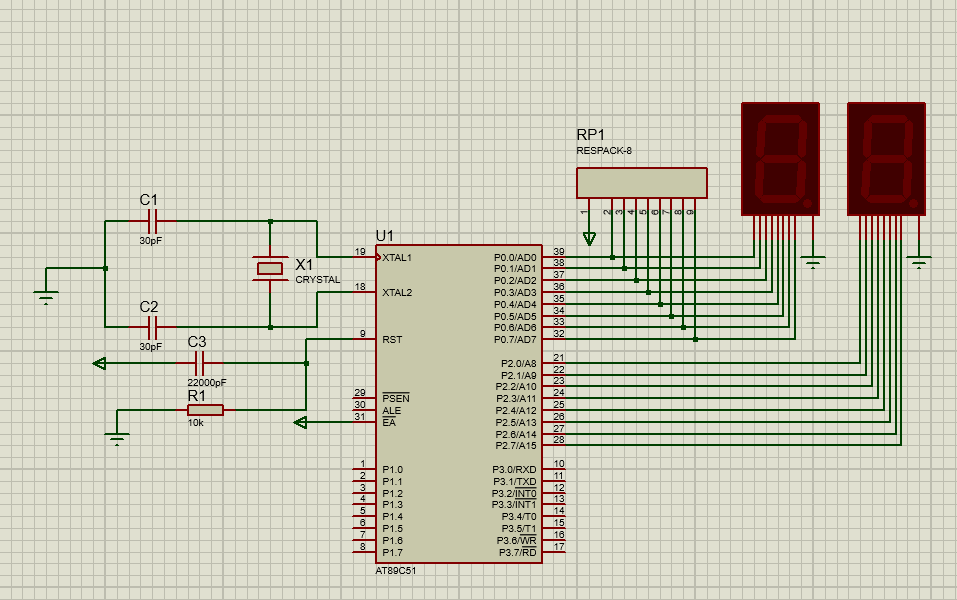

原理圖如下:
代碼如下:
ORG 0000H
LJMP MAIN
ORG 001BH        ;dingshizhongduan
LJMP DSZD
ORG 0060H
MAIN:
    MOV SP, #60H
    MOV TMOD, #10H
    MOV TH1, #3CH     ;50ms
    MOV TL1, #0C0H
    SETB EA
    SETB ET1
    SETB TR1
        MOV R1,#20
LOOP0:MOV R0,#00H
LOOP1:LCALL SKIP
          CJNE R0,#60, LOOP1
          SJMP LOOP0
DSZD:
    MOV TH1, #3CH     ;50ms
    MOV TL1, #0C0H
    DJNZ R1,LOOP
    INC R0
    MOV R1,#20
LOOP:RETI
SKIP:
    MOV A,R0
    MOV B, #10
DIV AB
MOV DPTR, #TAB
MOVC A, @A+ DPTR
MOV P0, A
MOV A,B
MOVC A, @A+ DPTR
MOV P2, A
    RET
TAB:
    DB  3FH,06H,5BH,4FH,66H,6DH,7DH,07H,7FH,6FH
    END
