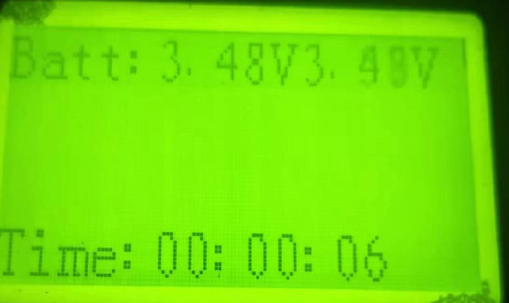

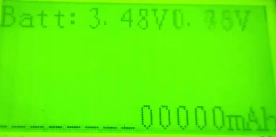

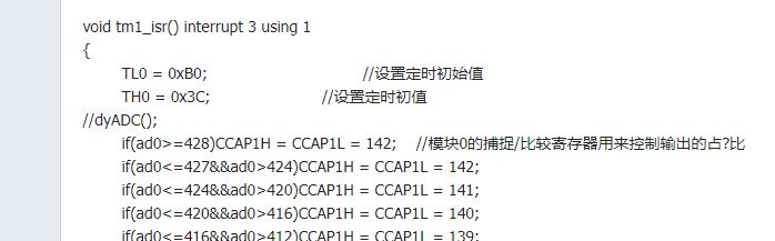

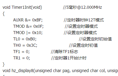

求助stc8051U 定時器t0不工作,pwm也沒工作
ID:322197 發(fā)表于 2025-1-24 11:23 | 只看該作者 |只看大圖 回帖獎勵 |倒序瀏覽 |閱讀模式

void tm1_isr() interrupt 3 using 1
        TL1 = 0x78;                //設(shè)置定時初值
        TH1 = 0xEC;                //設(shè)置定時初值
        if(ad0>=428)CCAP1H = CCAP1L = 142;    //模塊0的捕捉/比較寄存器用來控制輸出的占?比
        if(ad0<=427&&ad0>424)CCAP1H = CCAP1L = 142;
        if(ad0<=424&&ad0>420)CCAP1H = CCAP1L = 141;
        if(ad0<=420&&ad0>416)CCAP1H = CCAP1L = 140;
        if(ad0<=416&&ad0>412)CCAP1H = CCAP1L = 139;
        if(ad0<=412&&ad0>408)CCAP1H = CCAP1L = 138;
        if(ad0<=408&&ad0>404)CCAP1H = CCAP1L = 137;
        if(ad0<=404&&ad0>400)CCAP1H = CCAP1L = 136;
        if(ad0<=400&&ad0>396)CCAP1H = CCAP1L = 135;
        if(ad0<=396&&ad0>392)CCAP1H = CCAP1L = 134;
        if(ad0<=392&&ad0>388)CCAP1H = CCAP1L = 132;//
        if(ad0<=388&&ad0>384)CCAP1H = CCAP1L = 131;
        if(ad0<=384&&ad0>380)CCAP1H = CCAP1L = 129;
        if(ad0<=380&&ad0>376)CCAP1H = CCAP1L = 128;
        if(ad0<=376&&ad0>372)CCAP1H = CCAP1L = 127;
        if(ad0<=372&&ad0>368)CCAP1H = CCAP1L = 126;//
        if(ad0<=368&&ad0>364)CCAP1H = CCAP1L = 125;
        if(ad0<=364&&ad0>360)CCAP1H = CCAP1L = 123;
        if(ad0<=360&&ad0>356)CCAP1H = CCAP1L = 122;
        if(ad0<=356&&ad0>352)CCAP1H = CCAP1L = 120;
        if(ad0<=352&&ad0>348)CCAP1H = CCAP1L = 119;
        if(ad0<=348&&ad0>344)CCAP1H = CCAP1L = 117;
        if(ad0<=344&&ad0>340)CCAP1H = CCAP1L = 116;
        if(ad0<=340&&ad0>336)CCAP1H = CCAP1L = 114;
        if(ad0<=336&&ad0>332)CCAP1H = CCAP1L = 113;
        if(ad0<=332&&ad0>328)CCAP1H = CCAP1L = 111;
        if(ad0<=328&&ad0>324)CCAP1H = CCAP1L = 109;
        if(ad0<=324&&ad0>320)CCAP1H = CCAP1L = 108;
        if(ad0<=320&&ad0>316)CCAP1H = CCAP1L = 106;
        if(ad0<=316&&ad0>312)CCAP1H = CCAP1L = 105;
        if(ad0<=312&&ad0>308)CCAP1H = CCAP1L = 103;
        if(ad0<=304&&ad0>300)CCAP1H = CCAP1L = 100;
        if(ad0<=300&&ad0>296)CCAP1H = CCAP1L = 98;
        if(ad0<=296&&ad0>292)CCAP1H = CCAP1L = 97;
        if(ad0<=292&&ad0>288)CCAP1H = CCAP1L = 94;
        if(ad0<=288&&ad0>284)CCAP1H = CCAP1L = 91;
        if(ad0<=284)CCAP1H = CCAP1L = 0xFF;

void Timer1Init(void)                //5毫秒@12.000MHz
        AUXR &= 0xBF;                //定時器時鐘12T模式
        TMOD &= 0x0F;                //設(shè)置定時器模式
        TMOD |= 0x10;                //設(shè)置定時器模式
        TL0 = 0xB0;                                //設(shè)置定時初始值
        TH0 = 0x3C;                        //設(shè)置定時初值
        TF1 = 0;                //清除TF1標(biāo)志
        TR1 = 0;                //定時器1開始計時

運行時間和檢測電壓都正常,就是PMW不正常無輸出,把ADC關(guān)掉PMW有輸出

ID:1136941 發(fā)表于 2025-1-28 11:09 | 只看該作者
mhb7231 發(fā)表于 2025-1-27 20:59
這里的TL0,TH0改為TL1,TH1試試
6#
ID:1136941 發(fā)表于 2025-1-28 11:27 | 只看該作者
還有這里的初始化,TL0,TH0改為TL1,TH1
7#
ID:322197 發(fā)表于 2025-1-30 02:35 | 只看該作者
TL0,TH0改為TL1,TH1,還是不行,
