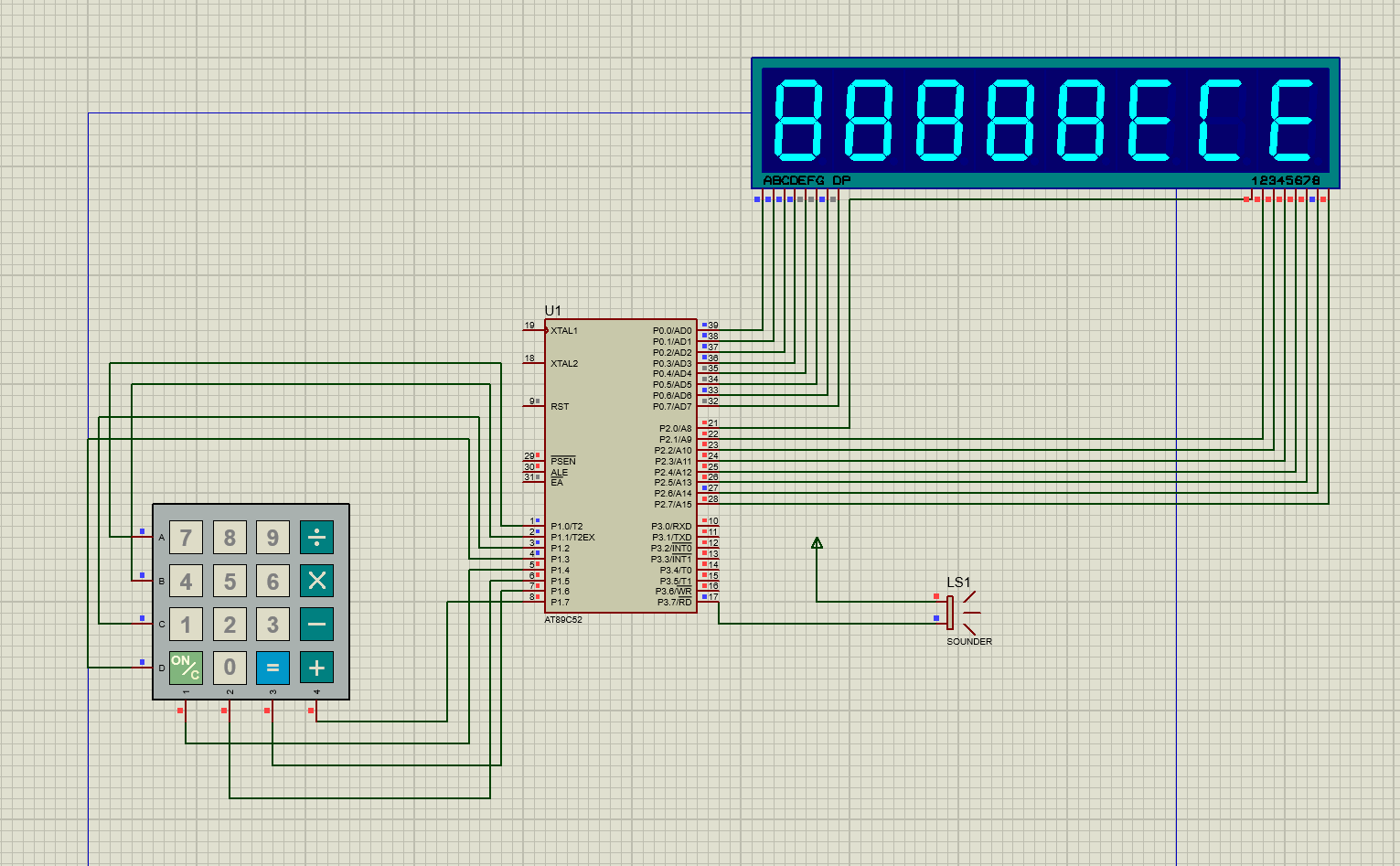

請問我這個(gè)簡易計(jì)算器為什么按計(jì)算器鍵盤的時(shí)候,出現(xiàn)的是亂碼呢,是因?yàn)槲业拇a....

#include <reg52.h>
sbit P0_0 = P0^0; sbit P0_1 = P0^1; sbit P0_2 = P0^2; sbit P0_3 = P0^3;
sbit P0_4 = P0^4; sbit P0_5 = P0^5; sbit P0_6 = P0^6; sbit P0_7 = P0^7;
#define uchar unsigned char
#define uint  unsigned int
uchar code SEGMENT[16] = {0xC0,0xF9,0xA4,0xB0,0x99,0x92,0x82,0xF8,
                          0x80,0x90,0x88,0x83,0xC6,0xA1,0x86,0x8E};
sbit ROW1 = P1^0; sbit ROW2 = P1^1; sbit ROW3 = P1^2; sbit ROW4 = P1^3;
sbit COL1 = P1^4; sbit COL2 = P1^5; sbit COL3 = P1^6; sbit COL4 = P1^7;
uchar display_buf[8] = {0,0,0,0,0,0,0,0};
uchar key_value = 0;
uchar flag_key = 0;
uchar op = 0;
uint num1 = 0, num2 = 0;
uint result = 0;
bit flag_op = 0;
sbit BEEP = P3^7;
uchar code KEY_MAP[4][4] = {
    {'7','8','9','/'},
    {'4','5','6','*'},
    {'1','2','3','-'},
    {'C','0','=','+'}
void delay_ms(uint ms) {
    uint i, j;
    for(i = 0; i < ms; i++)
        for(j = 0; j < 120; j++);
void Timer0_Init(void) {
    TMOD = 0x01;
    TH0 = 0xFC;
    TL0 = 0x18;
    ET0 = 1;
    EA = 1;
    TR0 = 1;
uchar seg_cnt = 0;
void Display_Scan(void) {
    P0 = SEGMENT[display_buf[seg_cnt]];
    P2 = ~(1 << seg_cnt);
    seg_cnt++;
    if(seg_cnt >= 8) seg_cnt = 0;
void Beep(void) {
    BEEP = 1;
    delay_ms(50);
    BEEP = 0;
uchar Key_Scan(void) {
    uchar row, col;
    ROW1 = ROW2 = ROW3 = ROW4 = 0;
    COL1 = COL2 = COL3 = COL4 = 1;
    if(COL1 == 0 || COL2 == 0 || COL3 == 0 || COL4 == 0) {
        delay_ms(20);
            ROW1 = 1; ROW2 = ROW3 = ROW4 = 0;
            if(COL1 == 0) { col = 0; row = 0; }
            else if(COL2 == 0) { col = 1; row = 0; }
            else if(COL3 == 0) { col = 2; row = 0; }
            else if(COL4 == 0) { col = 3; row = 0; }
            ROW2 = 1; ROW1 = ROW3 = ROW4 = 0;
            if(COL1 == 0) { col = 0; row = 1; }
            else if(COL2 == 0) { col = 1; row = 1; }
            else if(COL3 == 0) { col = 2; row = 1; }
            else if(COL4 == 0) { col = 3; row = 1; }
            ROW3 = 1; ROW1 = ROW2 = ROW4 = 0;
            if(COL1 == 0) { col = 0; row = 2; }
            else if(COL2 == 0) { col = 1; row = 2; }
            else if(COL3 == 0) { col = 2; row = 2; }
            else if(COL4 == 0) { col = 3; row = 2; }
            ROW4 = 1; ROW1 = ROW2 = ROW3 = 0;
            if(COL1 == 0) { col = 0; row = 3; }
            else if(COL2 == 0) { col = 1; row = 3; }
            else if(COL3 == 0) { col = 2; row = 3; }
            else if(COL4 == 0) { col = 3; row = 3; }
            return KEY_MAP[row][col];
    return 0;
void Calculate(void) {
    switch(op) {
        case 1: result = num1 + num2; break;
        case 2: result = num1 - num2; break;
        case 3: result = num1 * num2; break;
        case 4:
            if(num2 != 0) result = num1 / num2;
            else {
                display_buf[0] = 14; display_buf[1] = 13;
                display_buf[2] = 12; display_buf[3] = 0;
                display_buf[4] = 0; display_buf[5] = 0;
                display_buf[6] = 0; display_buf[7] = 0;
                return;
            break;
    display_buf[0] = result / 10000000;
    display_buf[1] = (result / 1000000) % 10;
    display_buf[2] = (result / 100000) % 10;
    display_buf[3] = (result / 10000) % 10;
    display_buf[4] = (result / 1000) % 10;
    display_buf[5] = (result / 100) % 10;
    display_buf[6] = (result / 10) % 10;
    display_buf[7] = result % 10;
void Update_Display(uchar key) {
    uchar i;
    if(key >= '0' && key <= '9') {
        if(!flag_op) {
            num1 = num1 * 10 + (key - '0');
            display_buf[7] = num1 % 10; display_buf[6] = (num1 / 10) % 10;
            display_buf[5] = (num1 / 100) % 10; display_buf[4] = (num1 / 1000) % 10;
            display_buf[3] = (num1 / 10000) % 10; display_buf[2] = (num1 / 100000) % 10;
            display_buf[1] = (num1 / 1000000) % 10; display_buf[0] = (num1 / 10000000) % 10;
        } else {
            num2 = num2 * 10 + (key - '0');
            display_buf[7] = num2 % 10; display_buf[6] = (num2 / 10) % 10;
            display_buf[5] = (num2 / 100) % 10; display_buf[4] = (num2 / 1000) % 10;
            display_buf[3] = (num2 / 10000) % 10; display_buf[2] = (num2 / 100000) % 10;
            display_buf[1] = (num2 / 1000000) % 10; display_buf[0] = (num2 / 10000000) % 10;
        Beep();
    } else if(key == '+' || key == '-' || key == '*' || key == '/') {
        flag_op = 1;
        if(key == '+') op = 1;
        else if(key == '-') op = 2;
        else if(key == '*') op = 3;
        else if(key == '/') op = 4;
        Beep();
    } else if(key == '=') {
        Calculate();
        flag_op = 0;
        num1 = result;
        num2 = 0;
        Beep();
    } else if(key == 'C') {
        num1 = num2 = 0;
        op = 0;
        flag_op = 0;
        for(i=0; i<8; i++) display_buf[i] = 0;
        Beep();
void Timer0_ISR(void) interrupt 1 {
    TH0 = 0xFC;
    TL0 = 0x18;
    Display_Scan();
void main(void) {
    Timer0_Init();
    while(1) {
        key_value = Key_Scan();
        if(key_value != 0 && !flag_key) {
            flag_key = 1;
            Update_Display(key_value);
        } else if(key_value == 0) {
            flag_key = 0;
ID:1121801 發(fā)表于 2025-6-4 14:24 | 顯示全部樓層
怎么個(gè)亂法也沒有顯示啊,是不是數(shù)碼管用錯(cuò)了,共陰與共陽用錯(cuò)了?
ID:1133081 發(fā)表于 2025-6-4 15:35 | 顯示全部樓層
8段數(shù)碼管不能顯示ASCII碼,要用點(diǎn)陣屏。
ID:1150590 發(fā)表于 2025-6-4 16:10 | 顯示全部樓層
cyi8 發(fā)表于 2025-6-4 14:24
就是鍵盤的按鍵,按了出來的東西不是對應(yīng)的數(shù)字和符號(hào),我用的是共陽的(這個(gè)應(yīng)該是沒錯(cuò)的)
ID:1150590 發(fā)表于 2025-6-4 16:13 | 顯示全部樓層
WL0123 發(fā)表于 2025-6-4 15:35
但是我要顯示的是數(shù)字好像也不太行
ID:1150590 發(fā)表于 2025-6-25 17:43 | 顯示全部樓層
這個(gè)問題已經(jīng)找到了,就是代碼的問題
ID:1152291 發(fā)表于 2025-6-27 14:52 | 顯示全部樓層
