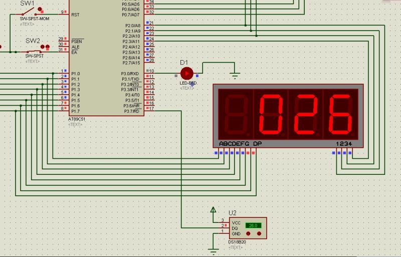

ID:262 發(fā)表于 2014-10-24 14:42 | 只看該作者 回帖獎勵 |倒序瀏覽 |閱讀模式
#include"reg51.h"
#define uchar unsigned char
#define uint unsigned int
#define led P1
#define ledw P2
uchar ledtab[]={0xc0,0xf9,0xa4, 0xb0,0x99,0x92,0x82,0xf8,0x80,0x90};
sbit dq=P3^7 ;
uchar delay,f;
void dela(uchar i)   //5us   t=5+i*2
while(--i);
void ds18b20_reset()
while(1)
dq=1;
dq=0;
delay=250;    //540us延時,當delay=1時延時為2us ,T=2*x
while(--delay);
dq=1;
delay=25;
while(--delay);
while(dq==0)
  delay=220;
  while(--delay);
  if(dq==1)
  break;
delay=150;
while(--delay);
break;
void ds18b20_write(uchar dat)
uchar i=0;
for(i=0;i<8;i++)
  dq=1;
  dq=0;
  delay=3;
  while(--delay);
  dq=dat&0x01;
  delay=35;
  while(--delay);
  dq=1;
  dat=dat>>1;
uchar ds18b20_read()
uchar i=0,m=0;
for(i=0;i<8;i++)
    //m>>=1
    dq=1;
  dq=0;
  delay=4;
  while(--delay);
  dq=1;
  delay=4;
  while(--delay);
  if(dq==1)
  m|=0x01<<i;
  //m=m|0x80;
   delay=25;
   while(--delay);
   dq=1;
   delay=1;
   while(--delay);
   return m;
uchar ds18b20_temp()
uchar temp=0,temph=0,templ=0,k=0;
ds18b20_reset();
ds18b20_write(0xcc);
ds18b20_write(0x44);
ds18b20_reset();
ds18b20_write(0xbe);
templ=ds18b20_read();
temph=ds18b20_read();
if((temph&0xf80)!=0)
  f=1;
  templ=~templ;
  temph=~temph;
  k=templ+1;
  templ=k;
  if(templ>0xff)
  temph++;
else
f=0;
templ=templ>>4;
temph=temph<<4;
temp=templ|temph;
return temp;
void main()
uchar a=0,b=0,c=0,temp=0;
while(1)
temp=ds18b20_temp();
a=temp/100;
b=temp0/10;
c=temp;
if(f==1)
  led=0xbf;
  ledw=1;
  dela(5000);
  ledw=0;
  dela(600);
led=ledtab[c];
ledw=8;
dela(5000);
ledw=0;
dela(600) ;
  led=ledtab;
  ledw=4;
    dela(5000);
  ledw=0;
  dela(600) ;
  led=ledtab[a];
  ledw=2;
  dela(5000);
  ledw=0;
  dela(600) ;
收藏收藏2 分享淘帖 頂 踩

坑爹啊,原理圖都不見
地板
ID:162582 發(fā)表于 2017-5-27 12:58 | 只看該作者
仿真顯示不正常?
