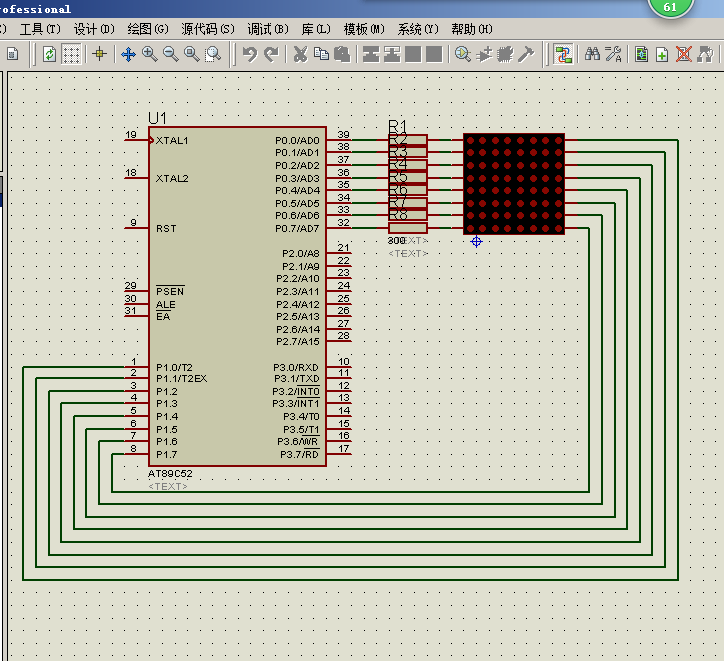

點陣基礎利用,利用點陣顯示單個基礎圖形
  1. #include<reg52.h>
  2. void delay1ms(unsigned int ms);
  3. void main()
  4. {
  5. unsigned char code led []={0x00,0x00,0xe7,0x00,0x00,0xe7,0x00,0x00};
  6. unsigned char w,i;
  7. while(1)
  8.         {
  9.         w=0x01;
  10.         for(i=0;i<8;i++)
  11.                 {
  12.                 P0=w;
  13.                 P1=led[i];
  14.                 delay1ms(1);
  15.                 w<<=1;
  16.                 }
  17.         }
  18. }
  19. void delay1ms(unsigned int ms)
  20. {unsigned i,j;
  21. for(j=0;j<ms;j++);
  22. for(i=0;i<110;i++);
  23. }
