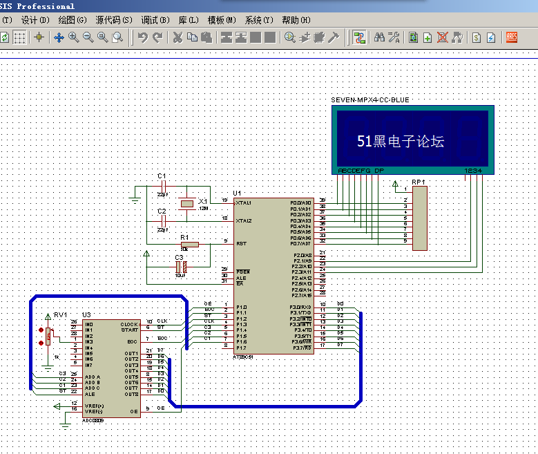

ADC0809模數(shù)轉(zhuǎn)換與顯示仿真
  1. /***************   writer:shopping.w   ******************/
  2. #include <reg52.h>
  3. #define uint unsigned int
  4. #define uchar unsigned char
  5. uchar code LEDData[]=
  6. {
  7.         0x3f,0x06,0x5b,0x4f,0x66,0x6d,0x7d,0x07,0x7f,0x6f
  8. };
  9. sbit OE  = P1^0;
  10. sbit EOC = P1^1;
  11. sbit ST  = P1^2;
  12. sbit CLK = P1^3;
  13. void DelayMS(uint ms)
  14. {
  15.         uchar i;
  16.         while(ms--)
  17.         {
  18.                  for(i=0;i<120;i++);
  19.         }
  20. }
  21. void Display_Result(uchar d)
  22. {
  23.         P2 = 0xf7;
  24.         P0 = LEDData[d%10];
  25.         DelayMS(5);
  26.         P2 = 0xfb;
  27.         P0 = LEDData[d%100/10];
  28.         DelayMS(5);
  29.         P2 = 0xfd;
  30.         P0 = LEDData[d/100];
  31.         DelayMS(5);
  32. }
  33. void main()
  34. {
  35.         TMOD = 0x02;                //設(shè)定定時(shí)器0為工作方式2
  36.         TH0  = 0x14;                //給定時(shí)器裝載初值
  37.         TL0  = 0x00;
  38.         IE   = 0x82;                //中斷控制寄存器,開總中斷,開定時(shí)器0中斷源
  39.         TR0  = 1;                //打開計(jì)時(shí)器0
  40.         P1   = 0x3f;                //初始控制信號(hào)
  41.         while(1)
  42.         {
  43.                  ST = 0;
  44.                 ST = 1;
  45.                 ST = 0;
  46.                 while(EOC == 0);
  47.                 OE = 1;
  48.                 Display_Result(P3);
  49.                 OE = 0;
  50.         }
  51. }
  52. void Timer0_INT() interrupt 1
  53. {
  54.         CLK = !CLK;
  55. }
