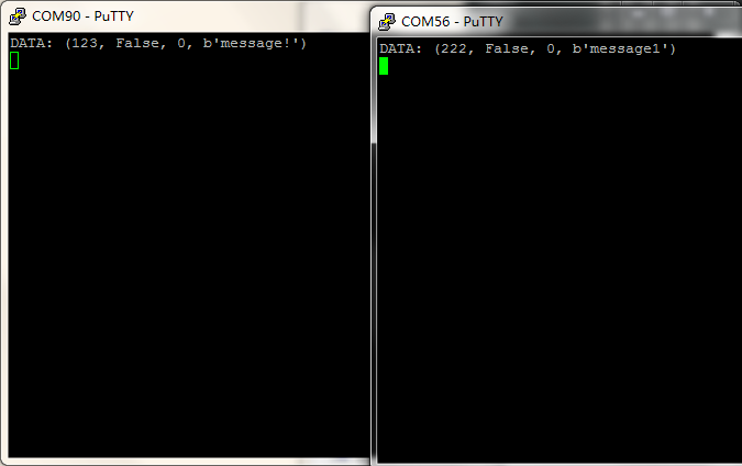

  第一個(gè)板子等待接收,當(dāng)接收到數(shù)據(jù)再發(fā)送。
  1. import pyb
  2. from pyb import CAN
  3. can = CAN(1, CAN.NORMAL)
  4. can.setfilter(0, CAN.LIST16, 0, (123, 124, 125, 126))  # set a filter to receive messages with id=123, 124, 125 and 126
  5. while True:
  6.     if can.any(0):
  7.         data=can.recv(0)            # receive message on FIFO 0
  8.         print('DATA:',data)
  9.         can.send(b'message1',222)
  第二板子是先發(fā)送,然后等待接收。
  1. # main.py -- put your code here!
  3. can = CAN(2, CAN.NORMAL)
  4. can.setfilter(0, CAN.LIST16, 0, (222,221,231,241))  # set a filter to receive messages with id=123, 124, 125 and 126
  5. can.send('message!', 123)   # send a message with id 123
  6. while True:
  7.     if can.any(0):
  8.         data=can.recv(0)            # receive message on FIFO 0
  9.         print('DATA:',data)
  0x05效果圖
