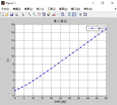

單入單出SISO系統(tǒng):
  1. clear all;
  2. close all;
  3. clc;
  4. M = 1000;
  5. Nt = [1];           % Nt = [2]; Nt = [4]; Nt = [8];
  6. Nr = [1];
  7. s={'b-hexagram'};
  8. SNR = [0:2:50]; %dB
  9. figure(1);
  10. title('單入單出系統(tǒng)');
  11. xlabel('SNR [dB]');
  12. ylabel('CU');
  13. grid on;
  14. hold on;
  15. for n = 1:length(Nt)
  16. t = Nt(n);
  17. r = Nr(n);
  18. for m = 1:M
  19. H = raylrnd(1,r,t);
  20. for l = 1:length(SNR)
  21. rou = 10^(SNR(l)/10);
  22. % Find the capacity while CSIT unknown
  23. CU(m,l) = log2(real(det(eye(r)+rou*H*H'/t)));
  24. end
  25. end
  26. C_unknown(:,n) = mean(CU)'
  27. for l = 1:length(SNR)
  28. [cdf_u,co_u] = hist(CU(:,l),100);
  29. cdf_u = cumsum(cdf_u);%數(shù)組累加
  30. idx_ten_percent = find(abs(cdf_u-100)==min(abs(cdf_u-100)));
  31. C_unknown_outage(l,n) = co_u(idx_ten_percent(1));
  32. end
  33. figure(1);
  34. linetype = s(n);
  35. plot(SNR,C_unknown(:,n),deal(linetype{:}));
  36. legend('Mt=1');
  37. end

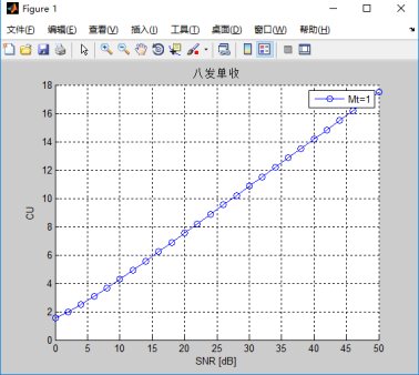

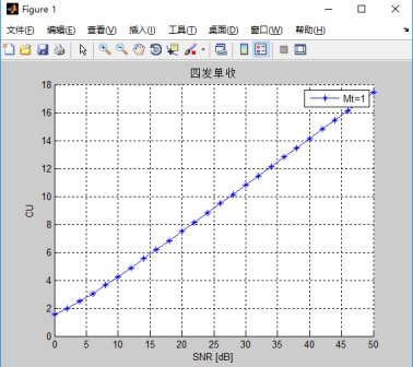

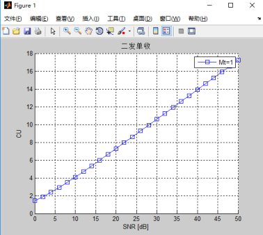

二發(fā)單收系統(tǒng):
四發(fā)單收系統(tǒng):
八發(fā)單收系統(tǒng):
