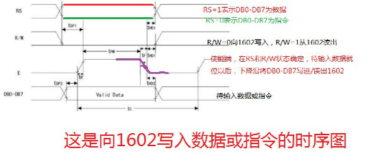

Library ieee;
Use ieee.std_logic_1164.all;
Use ieee.std_logic_unsigned.all;
Entity LCD1602 is
Port(clk,CR:in std_logic;
     RW,EN,RS:out std_logic;
       Qdata:out std_logic_vector(7 downto 0));
end;
Architecture LCD of LCD1602 is
signal Qfp:integer range 0 to 4999999;
signal cp:std_logic;
begin
  process(clk,CR)
     begin
          if CR='0' then
                Qfp<=0;
                    cp<='0';
               elsif clk'event and clk='1' then
                     Qfp<=Qfp+1;
                         if Qfp=0 then
                            cp<=not cp;
                         end if;
               end if;
     end process;
     RW<='0';
     EN<=cp;
     process(cp)
        variable cnt:integer range 0 to 37;
        begin
          if CR='0' then
             cnt:=0;
               Qdata<="00000001";
          elsif cp'event and cp='1' then
              cnt:=cnt+1;
          end if;
          case cnt is
          -------Init LCD1602-----------
          when 0 =>RS<='0';Qdata<="00111000";  --0x38,
          when 1 =>RS<='0';Qdata<="00001100";  --0x0C
          when 2 =>RS<='0';Qdata<="00000001";  --0x01
          when 3 =>RS<='0';Qdata<="00000110";  --0x60
          when 4 =>RS<='0';Qdata<="10000000";  --display,0x00+0x80,1h1w
          -------data display-------------
          when 5=>RS<='1';Qdata<="10100000";--空格
      when 6=>RS<='1';Qdata<="10100000";--空格
      when 7=>RS<='1';Qdata<="10100000";--空格
      when 8=>RS<='1';Qdata<="01011001"; --Y
      when 9=>RS<='1';Qdata<="01110101";--u
      when 10=>RS<='1';Qdata<="01101010";--j
      when 11=>RS<='1';Qdata<="01101001";--i
      when 12=>RS<='1';Qdata<="01100001";--a
      when 13=>RS<='1';Qdata<="01101110";--n
      when 14=>RS<='1';Qdata<="01110001";--q
      when 15=>RS<='1';Qdata<="01110101";--u
      when 16=>RS<='1';Qdata<="01100001";--a
      when 17=>RS<='1';Qdata<="01101110";--n
      when 18=>RS<='1';Qdata<="10100000";---空格
      when 19=>RS<='1';Qdata<="10100000";---空格
      when 20=>RS<='1';Qdata<="10100000";---空格
        when 21=>RS<='0';Qdata<="11000000";--設(shè)定顯示的位置在10H+80H,
       when 22=>RS<='1';Qdata<="01000100";---D diangong xueyuan
     when 23=>RS<='1';Qdata<="01101001";---i
     when 24=>RS<='1';Qdata<="01100001";---a
     when 25=>RS<='1';Qdata<="01101110";---n
     when 26=>RS<='1';Qdata<="01100111";---g
     when 27=>RS<='1';Qdata<="01101111";---o
     when 28=>RS<='1';Qdata<="01101110";--n
     when 29=>RS<='1';Qdata<="01100111";---g
     when 30=>RS<='1';Qdata<="10100000";--- 空格
     when 31=>RS<='1';Qdata<="01011000";---X
     when 32=>RS<='1';Qdata<="01110101";---u
     when 33=>RS<='1';Qdata<="01100101";---e
     when 34=>RS<='1';Qdata<="01111001";---y
     when 35=>RS<='1';Qdata<="01110101";---u
     when 36=>RS<='1';Qdata<="01100001";---a
     when 37=>RS<='1';Qdata<="01101110";---n
     end case;
      end process;
     end;

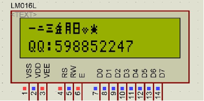

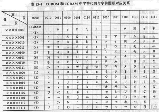

LCD1602顯示自定義字符或漢字
Library ieee;
Use ieee.std_logic_arith.all;
Entity LCD1602 is
end;
signal Qfp:integer range 0 to 499999;
Type GCROM is array(0 to 63)of std_logic_vector(7 downto 0);
constant xx:GCROM:=(
X"00",X"00",X"00",X"1F",X"00",X"00",X"00",X"00",--一
X"00",X"00",X"0E",X"00",X"1F",X"00",X"00",X"00",--二
X"00",X"1F",X"00",X"0E",X"00",X"1F",X"00",X"00",--//三
X"02",X"04",X"0F",X"12",X"0F",X"0A",X"1F",X"02",--//年
X"0F",X"09",X"0F",X"09",X"0F",X"09",X"09",X"11",--//月
X"1F",X"11",X"11",X"1F",X"11",X"11",X"1F",X"00",--//日
X"00",X"00",X"00",X"0A",X"15",X"0A",X"04",X"00",--//心型
X"00",X"04",X"15",X"0E",X"1F",X"0E",X"11",X"00"
constant yy:GCROM:=(
"01000000","01000001","01000010","01000011", "01000100","01000101","01000110","01000111",
"01001000","01001001","01001010","01001011", "01001100","01001101","01001110","01001111",
"01010000","01010001","01010010","01010011", "01010100","01010101","01010110","01010111",
"01011000","01011001","01011010","01011011", "01011100","01011101","01011110","01011111",
"01100000","01100001","01100010","01100011", "01100100","01100101","01100110","01100111",
"01101000","01101001","01101010","01101011", "01101100","01101101","01101110","01101111",
"01110000","01110001","01110010","01110011", "01110100","01110101","01110110","01110111",
"01111000","01111001","01111010","01111011", "01111100","01111101","01111110","01111111"
begin
  process(clk,CR)
     begin
      if CR='0' then
        Qfp<=0;
    cp<='0';
         Qfp<=Qfp+1;
     if Qfp=0 then
        cp<=not cp;
     end if;
   end if;
end process;
RW<='0';
EN<=cp;
process(cp)
    variable cnt:integer range 0 to 195;
  begin
  if CR='0' then
     cnt:=0;
   Qdata<="00000001";
       cnt:=cnt+1;
  end if;
  case cnt is
  when 0=>RS<='0';Qdata<="01000000";
      when 1=>RS<='1';Qdata<=xx(cnt-1);
  when 2=>RS<='0';Qdata<="01000001";
      when 3=>RS<='1';Qdata<=xx(cnt-2);
      when 4=>RS<='0';Qdata<="01000010";
      when 5=>RS<='1';Qdata<=xx(cnt-3);
  when 6=>RS<='0';Qdata<="01000011";
      when 7=>RS<='1';Qdata<=xx(cnt-4);
      when 8=>RS<='0';Qdata<="01000100";
      when 9=>RS<='1';Qdata<=xx(cnt-5);

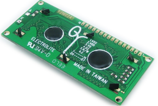

LCD1602相比大家都比較了解,但是我們一般只用來顯示字符,數(shù)字。
最近在網(wǎng)上看許多人用LCD1602來顯示漢字,覺得有趣
于是拜讀了一些資料,教程,但感覺大部分相當(dāng)晦澀難懂,本人認(rèn)為既然是教程,就不必要相當(dāng)?shù)膹?fù)雜,畢竟人家看完許久后還是不能得出實(shí)驗(yàn)結(jié)果~。
接下我談?wù)勎业米龇,保證你10分鐘之內(nèi)一樣可以在LCD1602上顯示你想顯示的各種符號(hào),漢字!!
首先:我們要弄清楚一個(gè)概念,其實(shí)我們使用1602顯示中文漢字,就是利用其內(nèi)部的自定義字節(jié)空間,我們都知道LCD1602內(nèi)部有一個(gè)64字節(jié)的自定義CGRAM,那么好,我們就是要利用自定義字節(jié)來達(dá)到顯示漢字的效果.
我們知道一個(gè)字符占8個(gè)字節(jié),所以在CGRAM能夠存放8個(gè)字符。
也就是說,這個(gè)64字節(jié)的CGRAM是給我們提供寫入數(shù)據(jù)的,
那么我們?cè)趺窗盐覀円臐h字寫入CGRAM呢?
不要急,大家查看LCD1602的用戶手冊(cè),里面提到當(dāng)我們需要想CGRAM寫入數(shù)據(jù)時(shí),我們需要先寫入CGRAM的地址,從手冊(cè)上可知,CGRAM的地址為0x40.所以當(dāng)我們要寫入數(shù)據(jù)時(shí),要先寫入一條地址命令 write_com(0x040);
然后把你要寫入的數(shù)據(jù)通過寫數(shù)據(jù)命令寫入  write_date( 你要寫得數(shù)據(jù));
做完以上步驟了,是不是LCD1602就會(huì)顯示你輸入的漢字呢?
不要急,以上你只是把你要顯示漢字的代碼存放在CGRAM里,就相當(dāng)于其他常用字符一樣固定在LCD里面了,如果你不把它讀出來,LCD是不會(huì)顯示的。。
當(dāng)你把上面的步驟做完后,接下來要做的與你平常怎么使用LCD1602是一樣的,只不過是LCD1602里面增加了一些你自定義的字符,漢字。
可能到這里,也許會(huì)有些疑問,既然自定義字符、漢字的代碼需要我們自己輸入,那么我該怎么編寫這些代碼,呵呵,不要著急,接下來就要用到下面這個(gè)取字模軟件。。

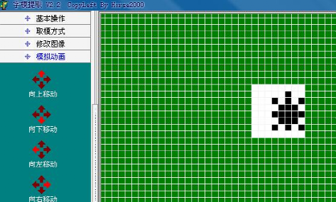

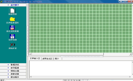

相信有的朋友應(yīng)該都用過這個(gè)軟件。那么我們?cè)趺磥硎褂眠@個(gè)軟件來獲取代碼呢?大家有沒有注意到,我們的LCD1602是5*8點(diǎn)陣(可以數(shù)一數(shù))。但是5*8不能提取代碼,最少只能8*8,所以我們這里只用后前5列,前3列不用。。
新建圖像 8*8.然后再圖像里面點(diǎn)你要顯示的字符,漢字,注意是在后5列中點(diǎn),黑點(diǎn)表示顯示,白點(diǎn)不顯示,用鼠標(biāo)左鍵可以切換,下面是我點(diǎn)得一個(gè)坦克~~

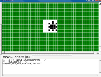

點(diǎn)好后,就可以產(chǎn)生代碼了,這軟件里面可以選擇C51或匯編,這里選擇C51。
下面的8個(gè)代碼就是要產(chǎn)生這個(gè)字符的數(shù)據(jù)。。也就是要輸入到自定義字符CGRAM里面的
好的,怎么把獲取漢字代碼,怎么把代碼輸入到CGRAM里面都知道了,
下面就是要把我們的自定義漢字、字符顯示在LCD1602屏幕上了。。
我們知道常用字符是從0x20開始顯示,而0x00—0x0f都是沒有用的,其實(shí)這個(gè)正式為我們自定義顯示字符準(zhǔn)備的。當(dāng)你把上面的代碼輸入到CGRAM中,LCD1602機(jī)會(huì)把漢字或字符賦予地址,這個(gè)地址是從0x00開始,因?yàn)樽疃嘀荒?個(gè)字符,所以當(dāng)在CGRAM里面輸入8個(gè)字符代碼時(shí),這8個(gè)字符的代碼的數(shù)據(jù)地址就是0x00開始到0x07。
所以當(dāng)你要在LCD1602上顯示自定義字符時(shí),只需要把這個(gè)地址用數(shù)據(jù)輸入就OK。
  Write_date(0x00—0x07);
也就是說現(xiàn)在你要顯示自定義字符和你顯示常用字符一樣的做法了,先寫地址,然后寫數(shù)據(jù)
自定義字符的數(shù)據(jù)就是0x00—0x07。也就是你自定義的8個(gè)字符。
這里用 Proteus 仿真軟件演示
附程序
