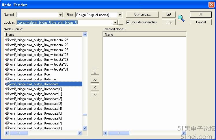

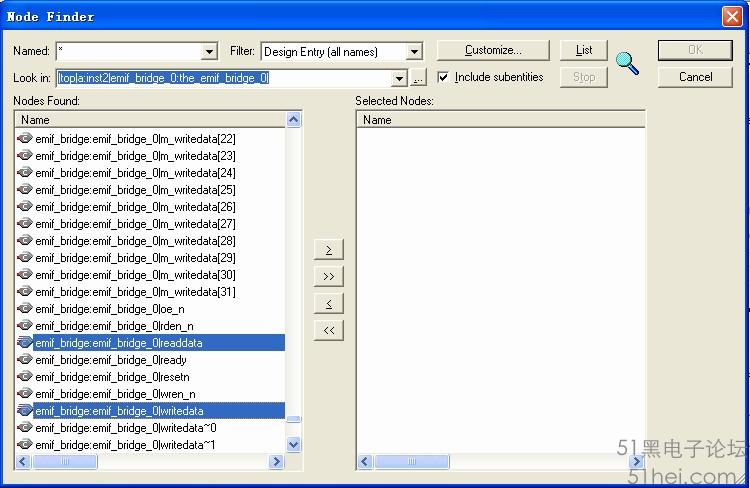

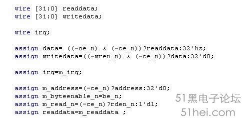

wire型數(shù)據(jù) readdata和writedata,綜合以后不能添加到SignalTap中觀測(cè)。
在待觀察的wire信號(hào)旁邊加上/*synthesis keep*/;
wire [31:0] readdata /* synthesis keep = 1 */;
