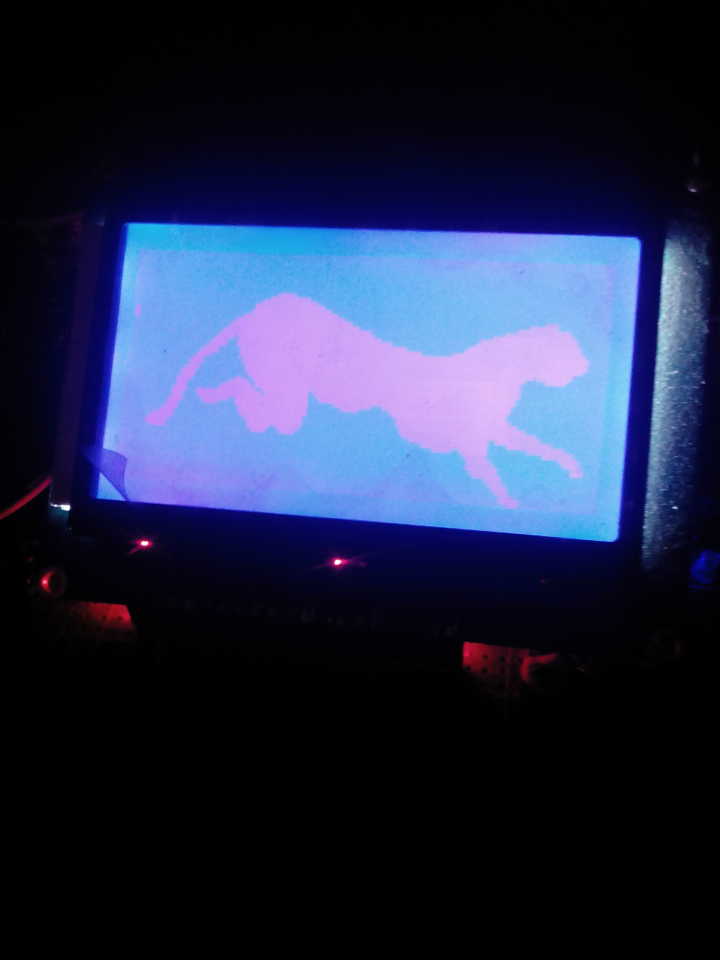

51單片機驅(qū)動12864顯示奔跑的獅子
ID:79544 發(fā)表于 2016-7-11 19:29 | 顯示全部樓層 |閱讀模式
51單片機驅(qū)動12864顯示連貫圖片

  462. 0x03,0x40,0x00,0x00,0x00,0x00,0x00,0x00,0x00,0x00,0x00,0x00,0x00,0x00,0x00,0x00,
  463. 0x05,0x40,0x00,0x00,0x00,0x00,0x00,0x00,0x00,0x00,0x00,0x00,0x00,0x00,0x00,0x00,
  464. 0x02,0xC0,0x00,0x00,0x00,0x00,0x00,0x00,0x00,0x00,0x00,0x00,0x00,0x00,0x00,0x00,
  465. 0x04,0x40,0x00,0x00,0x00,0x00,0x00,0x00,0x00,0x00,0x00,0x00,0x00,0x00,0x00,0x00,
  466. 0x07,0x40,0x00,0x00,0x00,0x00,0x00,0x00,0x00,0x00,0x00,0x00,0x00,0x00,0x00,0x00,
  467. 0x00,0x40,0x00,0x00,0x00,0x00,0x00,0x00,0x00,0x00,0x00,0x00,0x00,0x00,0x00,0x00,
  468. 0x00,0x40,0x00,0x00,0x00,0x00,0x00,0x00,0x00,0x00,0x00,0x00,0x00,0x00,0x00,0x00,
  469. 0x00,0x40,0x00,0x00,0x00,0x00,0x00,0x00,0x00,0x00,0x00,0x00,0x00,0x00,0x00,0x00,
  470. 0x00,0x40,0x00,0x00,0x00,0x00,0x00,0x00,0x00,0x00,0x00,0x00,0x00,0x00,0x00,0x00,
  471. 0x00,0x40,0x00,0x00,0x00,0x00,0x00,0x00,0x00,0x00,0x00,0x00,0x00,0x00,0x00,0x00,
  472. 0x00,0x40,0x00,0x00,0x00,0x00,0x00,0x00,0x00,0x00,0x00,0x00,0x00,0x00,0x00,0x00,
  473. 0x00,0xC0,0x00,0x00,0x00,0x00,0x00,0x00,0x00,0x00,0x00,0x00,0x00,0x00,0x00,0x00,
  474. 0x00,0x40,0x00,0x00,0x00,0x00,0x00,0x00,0x00,0x00,0x00,0x00,0x00,0x00,0x00,0x00,
  475. 0x02,0x40,0x00,0x00,0x00,0x00,0x00,0x00,0x00,0x00,0x00,0x00,0x00,0x00,0x00,0x00,
  476. 0x06,0x40,0x00,0x00,0x00,0x00,0x00,0x00,0x00,0x00,0x00,0x00,0x00,0x00,0x00,0x00,
  477. 0x02,0x40,0x00,0x00,0x00,0x00,0x00,0x00,0x00,0x00,0x00,0x00,0x00,0x00,0x00,0x00,
  478. 0x07,0x40,0x00,0x00,0x00,0x00,0x00,0x00,0x00,0x00,0x00,0x00,0x00,0x00,0x02,0x00,
  479. 0x00,0x40,0x00,0x00,0x00,0x00,0x00,0x00,0x00,0x00,0x00,0x00,0x00,0x00,0x03,0x00,
  480. 0x00,0x7F,0xFF,0xFF,0xFF,0xFF,0xFF,0xFF,0xFF,0xFF,0xFF,0xFF,0xFF,0xFF,0xFF,0x80,
  481. 0x02,0x00,0x40,0x20,0x10,0x08,0x04,0x01,0x00,0x20,0x08,0x02,0x00,0x10,0x03,0x00,
  482. 0x05,0x00,0x00,0x20,0x10,0x00,0x0E,0x03,0x80,0xE0,0x1C,0x07,0x00,0x48,0x02,0x00,
  483. 0x05,0x00,0x40,0x50,0x28,0x08,0x08,0x02,0x00,0x20,0x14,0x05,0x00,0xD4,0x00,0x00,
  484. 0x05,0x00,0xC0,0x20,0x10,0x18,0x0E,0x03,0x80,0x40,0x08,0x07,0x00,0x54,0x00,0x00,
  485. 0x02,0x00,0x40,0x40,0x08,0x3E,0x02,0x02,0x80,0x40,0x14,0x01,0x00,0x54,0x00,0x00,
  486. 0x00,0x00,0xE0,0x70,0x38,0x08,0x0E,0x03,0x80,0x40,0x1C,0x07,0x00,0xE8,0x00,0x00,
  487. };
  488. void delay(uint z)                //        延時函數(shù)
  489. {
  490.         uint x,y;
  491.         for(x=z;x>0;x--)
  492.          for(y=10;y>0;y--);
  493. }
  494. void delay1(uint z)                //        延時函數(shù)
  495. {
  496.         uint x,y;
  497.         for(x=z;x>0;x--)
  498.          for(y=600;y>0;y--);
  499. }
  500. //寫指令數(shù)據(jù)到LCD
  501. void write_cmd(uchar cmd)
  502. {
  503.         LCD_RS=0;
  504.         LCD_RW=0;
  505.         LCD_EN=0;
  506.         P0=cmd;
  507.                delay(5);
  508.         LCD_EN=1;
  509.         delay(5);
  510.         LCD_EN=0;
  511. }
  512. //寫顯示數(shù)據(jù)到LCD
  513. void write_dat(uchar dat)
  514. {
  515.         LCD_RS=1;
  516.         LCD_RW=0;
  517.         LCD_EN=0;
  518.         P0=dat;
  519.          delay(5);
  520.         LCD_EN=1;
  521.         delay(5);
  522.         LCD_EN=0;
  523. }
  524. void lcd_init1()//12964初始化字符串
  525. {
  526.         write_cmd(0x34);    //關(guān)閉畫圖功能
  527.     delay(20);
  528.         write_cmd(0x30);      //基本指令操作
  529.     delay(20);
  530.     write_cmd(0x0c);      //顯示開,光標(biāo)關(guān)
  531.     delay(20);
  532.     write_cmd(0x01);        //消除所有顯示
  533.     delay(20);
  534.          write_cmd(0x08);
  535.     delay(20);
  536.          write_cmd(0x06);
  537. }
  538. //12864初始化 圖片
  539. void lcd_init()//12964初始化
  540. {
  541.       //  LCD_PSB=1;                                //并口模式
  542.       /*  write_cmd(0x34);    //關(guān)閉畫圖功能
  543.         delay(20);
  544.                 write_cmd(0x30);      //基本指令操作
  545.         delay(20);
  546.         write_cmd(0x0c);      //顯示開,光標(biāo)關(guān)
  547.         delay(20);
  548.         write_cmd(0x01);        //消除所有顯示
  549.         delay(20);
  550.                  write_cmd(0x08);
  551.         delay(20);
  552.                  write_cmd(0x06);                  */
  553.
  554.
  555.                 write_cmd(0x3e); //8位數(shù)據(jù)傳輸,擴展指令操作,繪圖開
  556.         delay(2);
  557.                 write_cmd(0x01); //消除所有顯示
  558.         delay(2);
  559. }
  560. //清整個CDRAM空間-----------
  561. void clrgdram()
  562. {
  563. /*         //這樣清屏效果不好
  564.         uchar i,j,k;
  565.          uchar lcd_x,lcd_y;
  566.          lcd_x=0x80;
  567.          lcd_y=0x80;
  568.          write_cmd(0x34);
  569.          for(i=0;i<2;i++)
  570.          {
  571.          for(j=0;j<32;j++)
  572.          {
  573.          write_cmd(lcd_y+j);
  574.          write_cmd(lcd_x);
  575.          for(k=0;k<16;k++)
  576.          {
  577.          write_dat(0x00);
  578.          }
  579.          }
  580.          lcd_x=0x88;  }
  581. //         write_cmd(0x36);
  582.          write_cmd(0x30);
  583.    */
  584.    //正常清屏效果
  585.    uchar x,y ;
  586.     for(y=0;y<64;y++)
  587.     for(x=0;x<16;x++)
  588.     {
  589.         write_cmd(0x34);
  590.         write_cmd(y+0x80);
  591.         //行地址
  592.         write_cmd(x+0x80);
  593.         //列地址
  594.         write_cmd(0x30);
  595.         write_dat(0x00);
  596.         write_dat(0x00);
  597.     }
  598. }
  599. //清屏
  600. void clrscreen()
  601. {
  602.     write_cmd(0x01);
  603.     delay(10);
  604. }
  605. //顯示整屏函數(shù)
  606. void display(uchar code *add)//顯示圖片函數(shù)
  607. {                                         //address是是指向數(shù)組的指針,用法:show_Pic(XY)當(dāng)中XY為數(shù)組名
  608.     uchar i,j;
  609.     for(i=0;i<32;i++)      //上半屏的32排依次先寫滿
  610.     {
  611.         write_cmd(0x80+i); //先送垂直地址
  612.         write_cmd(0x80);   //再送水平地址,水平地址可自加1
  613.         for(j=0;j<16;j++) //每排128個點,所以一共要16個兩位16進制數(shù)(也就是8位二進制數(shù))才能全部控制
  614.         {
  615.             write_dat(*add);
  616.                  add++;
  617.         }
  618.     }
  619.     for(i=0;i<32;i++)     //下半屏的32排操作原理和上半屏一樣
  620.     {
  621.         write_cmd(0x80+i);
  622.         write_cmd(0x88);
  623.         for(j=0;j<16;j++)
  624.         {
  625.             write_dat(*add);
  626.                  add++;
  627.         }
  628.     }
  629.
  630. }
  631. void display1(uchar code *add)//顯示圖片函數(shù)
  632. {
  633.         //畫圖像
  634.         uchar i,j,k,lcd_x,lcd_y;
  635.         lcd_x=0x80;
  636.         lcd_y=0x80;
  637.         write_cmd(0x34);//打開擴充功能
  638.          write_cmd(0x36);//打開繪圖功能
  639.         for(i=0;i<2;i++)   //分為上下兩屏
  640.          {
  641.          for(j=0;j<32;j++)
  642.          {
  643.          write_cmd(lcd_y+j);
  644.          write_cmd(lcd_x);
  645.          for(k=0;k<16;k++)  //寫入顯示數(shù)據(jù)
  646.          {
  647.          write_dat(*add++);
  648.          }
  649.          }
  650.          lcd_x=0x88;//將x地址指向下半屏
  651.           }
  652.
  653.            write_cmd(0x30);//操作恢復(fù)為常用指令
  654. }
  655. void set_cursor(uchar x,uchar y)
  656. {
  657.         uchar i;  switch(x)           //確定行號
  658.         {
  659.                 case 0x00: i=0x80; break;    //第一行
  660.                 case 0x01: i=0x90; break;     //第二行
  661.                 case 0x02: i=0x88; break;     //第三行
  662.                 case 0x03: i=0x98; break;     //第四行
  663.                 default : break;
  664.         }
  665.         i = y+i;          //確定列號
  666.         write_cmd(i);
  667. }
  668. //指定位置顯示字符串函數(shù)  //參數(shù)說明:x為行號,y為列號
  669. void display_string(uchar x,uchar y,uchar *Alphabet)
  670. {
  671.         uchar i=0;  set_cursor(x,y);    //設(shè)置顯示的起始地址
  672.         while(Alphabet[i]!='\0')
  673.         {
  674.                 write_dat(Alphabet[i]);   //寫入需要顯示字符的顯示碼
  675.                 i++;
  676.         }
  677. }
  678. //主函數(shù)
  679. void main()
  680. {
  681.         uchar i,j;
  682.         lcd_init(); //初始化
  683.         delay(10);
  684.
  685. //        clrscreen();
  686.         write_cmd(0x01);
  687.         delay(300);
  688.     while(1)
  689.         {
  690.                 clrgdram();
  691.                 delay(30);
  692.                 display_string(0,2,"我愛單片機");
  693.                 display_string(1,1,"奔跑的獅子");
  694.                 display_string(2,0,"努力執(zhí)著不斷努力");
  695.                 display_string(3,0,"創(chuàng)造美好的明天!");
  696.                 delay1(5000);
  697.                 write_cmd(0x01);
  698.                 delay(100);
  699.                 for(j=0;j<8;j++)  //顯示8遍
  700.                 {
  701.                            for(i=0;i<6;i++) //顯示7幅圖畫
  702.                         {
  703.                            display1(table0+16*64*i);
  704.                            delay(1);
  705.                         }
  706.                 }
  707.                 clrgdram();
  708.                 delay(50);
  709.            write_cmd(0x01);
  710.            delay(10);
  711.         }
  712. }
