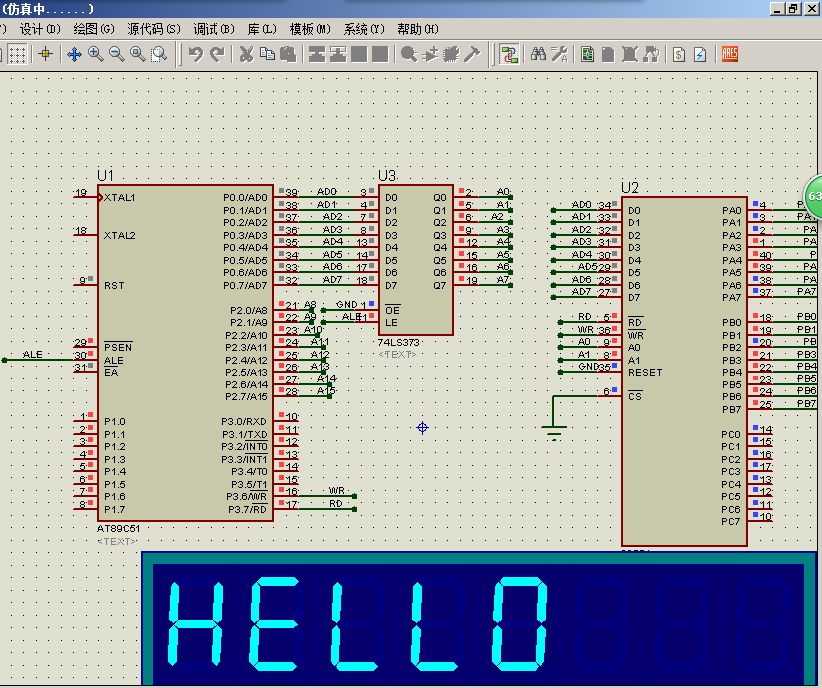

分享一個(gè)51單片機(jī)用LED數(shù)碼管來(lái)動(dòng)態(tài)顯示HELLO的proteus仿真下面是原理圖:
單片機(jī)源程序:
  1. #include <reg51.h>
  2. #include <absacc.h>
  3. #define PA XBYTE[0XFF3C]
  4. #define PB XBYTE[0XFF3D]
  5. #define PC XBYTE[0XFF3E]
  6. #define PK XBYTE[0XFF3F]
  7. unsigned char code led[]={0x76,0x79,0x38,0x38,0x3f};
  8. unsigned char k[]={0xfe,0xfd,0xfb,0xf7,0xef};
  9. void delay(int n)
  10. {while(n--)
  11. {int i,j;
  12. for(i=0;i<10;i++)
  13. for(j=0;j<10;j++);
  14. }
  15. }
  16. void main()
  17. {PK=0X80;
  18. while(1)
  19. {int i;
  20. for(i=0;i<5;i++)
  21. {PA=led[i];
  22. PB=k[i];
  23. delay(10);
  24. PB=0XFF;
  25. }
  26. }
  27. }

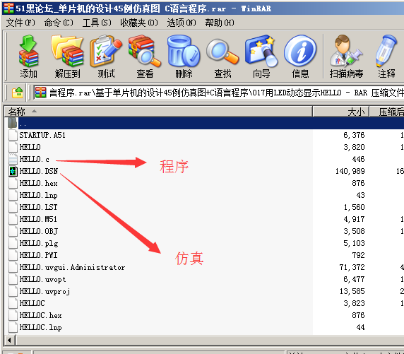

仿真工程文件及所有完整程序等資料下載地址(壓縮包一共有45個(gè)單片機(jī)仿真,全部下載后找到第017個(gè)項(xiàng)目即可):
http://www.torrancerestoration.com/bbs/dpj-56298-1.html
