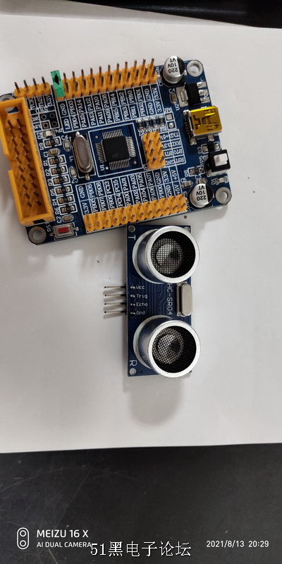

ID:592807 發(fā)表于 2021-8-13 20:32 | 顯示全部樓層
123689 發(fā)表于 2021-8-13 16:34
這個(gè)連最開(kāi)始的“超聲波初始化”都沒(méi)得!
我找時(shí)間試一下。買了買還用

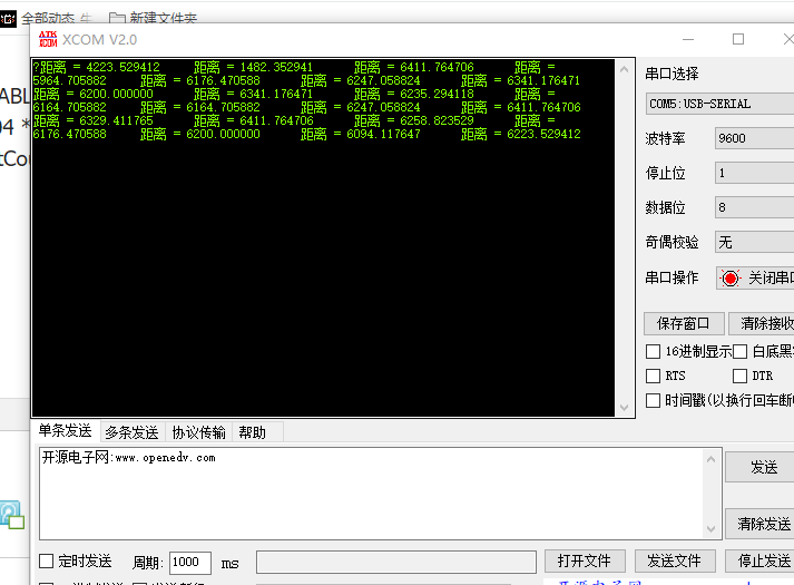

ID:592807 發(fā)表于 2021-8-14 12:29 | 顯示全部樓層
u8 combuff[2048];
u8 combuff1[2048];
int main(void)
        double cm_length = 0;
        u8 i = 0;
        delay_init();
        USART1_Init(9600);
        TIM3_Init(1,1);//1ms
        TIM16_Init(1,1);//1ms
        HC_RC04_Init();
        while(1)
                delay_ms(1000);delay_ms(1000);delay_ms(1000);delay_ms(1000);delay_ms(1000);
                for(i = 0;i<5;i++)
                        cm_length += (Start_HC_RC04()/5);
//length * 2 /340
                cm_length = (cm_length / 170) * 100;
                u1_printf("距離 = %1f\r\n",cm_length);
                cm_length=0;
GPIO        初始化
VCC = 3.3V
GND = 0V
TRIG = PA7
ECHO = PA6
void HC_RC04_Init(void)
  GPIO_InitTypeDef GPIO_InitStructure;
        RCC_AHBPeriphClockCmd(RCC_AHBPeriph_GPIOA, ENABLE);  //使能GPIOA的時(shí)鐘
        GPIO_InitStructure.GPIO_Pin = GPIO_Pin_7;
        GPIO_InitStructure.GPIO_Mode = GPIO_Mode_OUT;
        GPIO_InitStructure.GPIO_Speed = GPIO_Speed_50MHz;
        GPIO_InitStructure.GPIO_OType = GPIO_OType_PP;
        GPIO_InitStructure.GPIO_PuPd = GPIO_PuPd_NOPULL;
        GPIO_Init(GPIOA, &GPIO_InitStructure);
        GPIO_InitStructure.GPIO_Pin = GPIO_Pin_6;
        GPIO_InitStructure.GPIO_Mode = GPIO_Mode_IN;
u16 msHC_RC04;
1ms中斷
void TIM3_IRQHandler(void)
        u8 i;
  if (TIM_GetITStatus(TIM3, TIM_IT_Update) != RESET)
                msHC_RC04+=1;
    TIM_ClearFlag(TIM3, TIM_FLAG_Update);
ECHO(PA6) 先確保        ECH處于低電平
TRIG(PA7) 先拉高20us以上、
ECHO (PA6)  電平被拉高后開(kāi)啟定時(shí)器
ECHO (PA6)  電平拉低后關(guān)閉定時(shí)器并且讀取時(shí)間
測(cè)試距離 = (高電平時(shí)間(S) * 340M/S)/2
模塊測(cè)距范圍2-400cm
因此高電平時(shí)間范圍0.1ms - 23ms
u32 Start_HC_RC04(void)
        u16 time_out = 0;
        u32 usTime = 0;
        GPIO_ResetBits(GPIOA,GPIO_Pin_7);
        delay_us(20);
        while(GPIO_ReadInputDataBit(GPIOA,GPIO_Pin_6) != 0)
                        delay_ms(1);
                        time_out += 1;
                        if(time_out >= 1000)
                                u1_printf("超時(shí)\r\t");
                                return 0;
                GPIO_SetBits(GPIOA,GPIO_Pin_7);
                delay_us(20);
                GPIO_ResetBits(GPIOA,GPIO_Pin_7);//觸發(fā)信號(hào)
                while(GPIO_ReadInputDataBit(GPIOA,GPIO_Pin_6) == 0)
                msHC_RC04 = 0;
                TIM_Cmd(TIM3, ENABLE);
                while(GPIO_ReadInputDataBit(GPIOA,GPIO_Pin_6) == 1)
                TIM_Cmd(TIM3, DISABLE);
                usTime = msHC_RC04 * 1000;
                usTime += (TIM_GetCounter(TIM3)*100);//時(shí)鐘1S 10000節(jié)拍。1節(jié)拍0.1ms 100us
                TIM1->CNT = 0;
                return usTime;
時(shí)間和距離的轉(zhuǎn)換沒(méi)您好,也沒(méi)怎么濾波。
