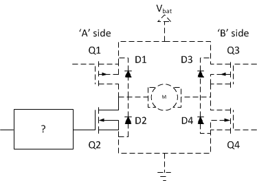

Low-side drivers
In the following I will only deal with one-half of the bridge. The second half needs identical treatment, so I’m going to ignore that for a while. On the low-side, we only have one type of device to deal with: N-channel FETs. These need a low voltage to turn them off, and a higher voltage (typically in the 5…15V range) to turn them fully on. The question is: what to put in the place of the mystery circuit:
The simplest drive circuitry: none
For very simple, low-voltage designs, they might be completely missing, and the FETs are directly driven by logic level signals.
This technique however only works under limited circumstances:
  • You have to make sure that the output voltages of the digital logic are in fact capable of turning the FET fully on. This was true in out previous example, but if you’ve used lower-voltage logic (3.3V or even lower) or wanted to have higher currents through the bridge, it would not have been the case
  • The logic output has enough current to generate the required turn-on and –off times. This is especially important for logic output with asymmetrical drive capabilities, like open-drain CMOS outputs or TTL chips.

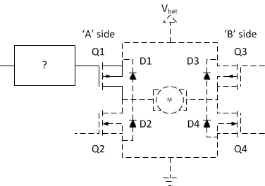

High-side P-MOS drivers
So far we’ve only talked about driving N-MOS devices and driving them on the low-side. Let’s consider now the high-side drivers, first for P-MOS devices:
This configuration present some complications: P-MOS transistors are open (non-conducting) when their gate is at close to the same potential as their source, and closed (conducting) when the gate is at a significantly lower potential, -5…-15V lower. This means that in order to completely turn off a high-side P-FET we’ll have to drive it’s gate as high as it’s source, which is connected to the power supply. To turn the FET on, we have to lower the gate voltage by 5…15V below Vbat.
All the drive circuits we’ve discussed before can be used for high-side P-FETs with the following change: you have to power the driver stage from the same voltage as the bridge is operating on, that is Vbat. That way, the high-level output voltage will be Vbat, which will turn the P-FET off properly, and the low-level output voltage will be 0, that is almost always enough to turn the FET on. (You might have problems with extremely low Vbat voltages, where you would have to drive the gate to a negative voltage to turn the FET on properly. This however is a rare enough case to ignore simply because high-current H-bridges usually operate at higher voltages and low-voltage H-bridges have low-enough currents that a small logic-level FET can be used in them that can be turned on by -Vbat.)
Direct logic drive complications
The additional limitation of the driver operating from Vbat has a significant consequence for direct logic-gate driven bridges: a simple AHC series gate, like the one we’ve used before will only be able to function in this role if the bridge power supply is lower than the maximum supply the gate itself can be operated from, that is, less than 5V. This is a very serious limitation as most bridges but the smallest ones operate from higher voltages to maximize power delivery without requiring enormous currents.
With all that, for small motors this approach can result in a good, cheap solution. For a practical example, take a look at the Servo Brain μModule project.
High-voltage drive complications

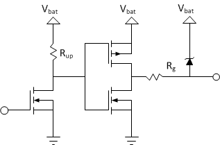

One of the major contributors to premature MOSFET deaths is gate-oxide break-down. The major cause of the breakdown is too high gate-source voltage on a MOSFET. The datasheets always specify this value, and for power MOSFETs at least the value is usually +/-20V. Getting out of this region will very quickly destroy the FET.
This presents a problem for the high-side P-MOS drivers: if Vbat is higher than 20V, we can’t allow the gate drive to go down to 0V any more for low levels. It can go only as low as – say – Vbat-15V to allow for some safety margin as well. This is usually accomplished by adding a Zenner diode to the drive circuit:
If you set the Zenner voltage to about 15V, it will limit your voltage difference between the output and Vbat to be within the safe limits.
Similar limitations are needed on the low-side as well, if your driver works from Vbat and not from a separate power supply.

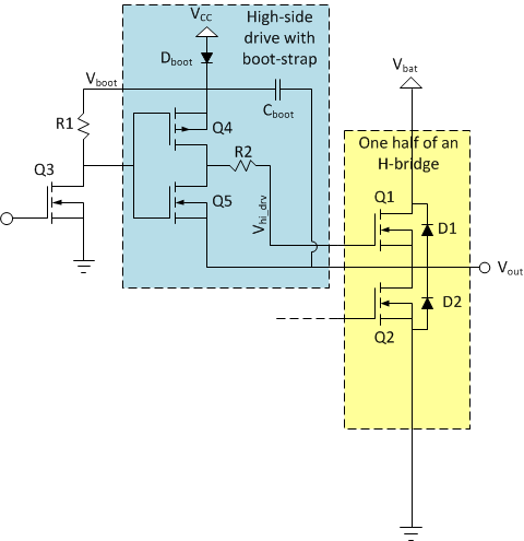

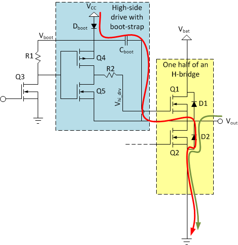

N-MOS high-side drive circuits
So far we’ve only discussed driving P-MOS devices on the high-side. With all the complexities of level-shifting and voltage-limiting, P-MOS drivers are still simpler than drivers for an N-channel device.
The reason is the following: The source of an N-channel device on the high-side has to be connected to the motor terminal and its drain to the power supply, otherwise the body-diode would be forward-biased and would always conduct. To turn off an N-MOS device in that configuration, you can connect the gate to ground or to the source: gate-source voltage is going to be below or equal to 0. But where to connect the gate to open the device? The power supply is not enough, since, if the device is already open, it’s source and drain are roughly at the same potential. As the drain is connected to power, the source will be at that level as well, but than gate should be higher than that to keep the device open. We’ve seen that the gate should be at minimum 4.5V higher for our example above, and for some other devices maybe as much as 10-15V higher.
As Vbat is usually the highest voltage directly available in a system, this voltage needs to be generated. In most cases some kind of a charge-pump is used for that generation, mostly in a boot-strapped configuration:
While actual implementations could be quite a bit more complex, I will use this simplified variant to explain how things work. These circuits are usually operated form a voltage supply (Vcc) somewhere between 8 and 15V, for our discussion let’s say it’s working from 12V.

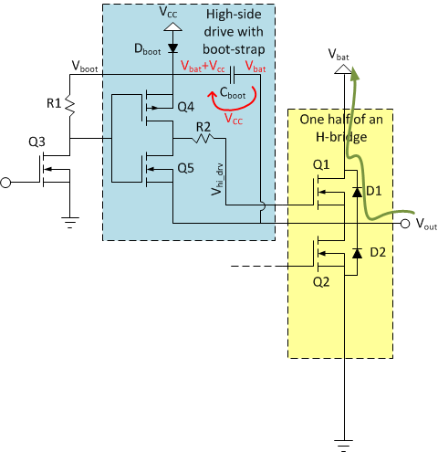

This high-side driver shows strong similarities to the P-MOS high-side drivers we’ve discussed before, there are significant differences. While it also consists of a level-shifter (Q3, R1) followed by a C-MOS driver stage (Q4, Q5), this stage is neither grounded nor is connected to power. The lower leg of it is connected to the middle terminal of the bridge, or more importantly to the source of the power FET it drives, Q1. This means that the low-level output voltage of this stage (Vhi_drv) will be the same potential that the source of Q1 is, whatever that happens to be.
Let’s now see, what the voltage (Vboot) of the higher leg of the driver – that determines the high-level output voltage – is! To understand the operation of the circuit you’ll have to imagine that both the high- and the low-sides are driven by a PWM signal. We close Q2 for some portion of every cycle, and Q1 for the rest (not counting shoot-through protection for a minute).
For the part of the cycle, when Q2 conducts, the output terminal voltage (Vout) is 0V, or very close to it. Since one side of Cboot is connected to this node, it is also grounded. Dboot, which is connected between Vcc and the other side of Cboot will make sure that Cboot is charged up to Vcc:
This of course also means that Vboot is equal to Vcc, 12V in our example. When it comes to turning Q2 off, Vout starts floating. Depending on what the motor, and the other side of the bridge does, either D1 or D2 will open and continue conducting the motor current.
If D2 openes, Vout would stay at 0V (actually it would go slightly negative to open D2, but let’s ignore that for now), so Cboot and Vboot stays as they were: charged up to Vcc, or 12V higher than Vout.
If we wanted to turn Q1 on at this point, Q4 can easily drive it’s gate 12V higher than it’s source terminal voltage (Vout), so we can clearly open it.
If however D1 starts conducting after we opened Q2, Vout rises to Vbat (again, slightly higher, to forward-bias the diode, but I’ll ignore that here). When that happens – since the voltage across Cboot can’t change abruptly – Vboot has to rise and reach Vbat+Vcc. Normally, Cboot would discharge quickly towards Vcc, but in our case Dboot closes and lets Vboot rise as high as it wishes:
At that point Vout is at Vbat and Vboot is higher than that by Vcc (12V). If we wanted to turn Q1 on at this point, we can still do it: the high-level output voltage of the driver (Vboot) is 12V higher than the source voltage of Q1, as it is connected to Vout.
All in all, Cboot and Dboot will make sure that Vboot is always at a higher voltage than Vout by Vcc. Or at least most of the time. The problem is that whenever Vboot is higher than Vcc, the only thing that keeps it at that level is the charge kept in Cboot. Any current that’s flowing out of that node will discharge the capacitor and eventually bring back Vboot to only Vcc. In our simple circuit, most of that current will flow through R1, but even if we solved that, other leakage currents through the various components will eventually do that. It takes a long time, probably seconds, but inevitably it will happen. What it means is that, while this circuit can certainly turn Q1 on, it can’t keep it turned on indefinitely.

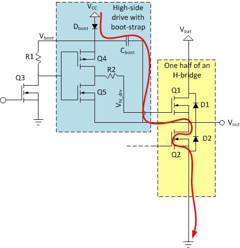

The most important consequence is that bridges driven by this type of driver can’t operate at 100% duty-cycle: you’ll have to give some in every cycle for Cboot to re-charge.
As far as drive modes go, the circuit doesn’t put a significant limitation on the number of options available. For lock anti-phase drive, all four FETs are switching, so there is not problem at all, but for the two sign-magnitude drives, you’ll have to make sure that the FET that’s continuously on is on the low-side.
Another problem worth mentioning is this: when you try to open Q1, that is you turn Q4 on, you basically connect Cboot and the gate-capacitance of Q1 in parallel. If Dboot is closed, so the only place to get charge to the gate is from Cboot, you are essentially just re-distributing the charge between the two capacitors. As that happens, the voltage on them will get lower, and the gate-voltage you can achieve depends on the ratio of the two capacitances:
Vgate = Vcc * Cboot / (Cboot + Cgate)
What this means is that if you want to make sure that Vgate is – let’s say – within 10% of Vcc, you have to make sure that Cboot is about an order of magnitude higher than the gate-capacitance of Q1. We’ve seen that the gate-capacitance of large FETs can be several nF, so Cboot should be in the 47-100nF range for those devices.
The last thing to talk about is that as the bridge is switching, Dboot keeps opening to top-up Cboot. But how much current will flow through it? As I’ve drawn the circuit above, the only thing limiting this current is the internal resistance of Dboot and the wires connecting them. All in all, there could be a significant current-spike on Vcc through Dboot due to the operation of the charge-pump. The power supply generating Vcc has a finite internal resistance, so this current-spike will translate into a periodic voltage drop on Vcc. To prevent that, usually a resistor is connected in series with Dboot to control the current flowing in the capacitor. It’s value is determined to make sure that you can completely re-charge Cboot even under worst-case duty-cycle conditions:
Let’s say you allow for a maximum of 99% duty cycle, your gate capacitance is 5nF, Cboot is 100nF, Vcc is 12V and the operating frequency of the bridge is 20kHz. This means that you will charge the gate of Q1 up to 12V (disregarding now the voltage drop on Dboot and due to the charge-redistribution phenomena we’ve discussed above) 20000 times a second. Each time you charge the capacitor up, you need 5nF * 12V = 60nQ of charge. Since you do that 20000 times a second, the total charge transferred to the capacitor over a second is 1.2mQ, or in other words, your average gate-current is 1.2mA.
Let’s say (due to charge-redistribution and other leakage paths) under worst-case conditions Cboot looses 10% of its charge during the on-time. This results in a 1.2V drop on Vboot, that needs to be replenished during the off-time, which is (under worst-case conditions) 1% of the total cycle-time, or 500ns. To charge a capacitor of 100nF up by 1.2V in 500ns, you need 0.24A of (peak) charge current to do it.
From this quick calculation you see that the peak current (flowing through Rboot and Dboot) can be quite large compared to the modest average current flowing to the gate of Q1. This is important as this high current will stress your power delivery network, and can be a strong noise source for other parts of your design.
If you are curious, there’s plenty of more detail about these boot-strap circuits in device datasheets and application notes, like this one: http://www.fairchildsemi.com/an/AN/AN-6076.pdf
