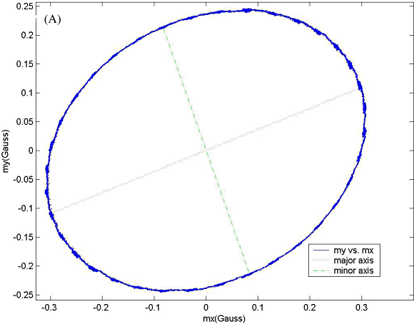

Soft-Iron Distortion. Unlike hard-iron distortion where the magnetic field is additive to the earth's field, soft-iron distortion is the result of material that influences, or distorts, a magnetic field—but does not necessarily generate a magnetic field itself, and is therefore not additive. Iron and nickel, for example, will generate a soft-iron distortion. While hard-iron distortion is constant regardless of orientation, the distortion produced by soft-iron materials is dependent upon the orientation of the material relative to the sensor and the magnetic field. Thus, soft-iron distortion cannot be compensated with a simple constant; instead, a more complicated procedure is required.
As shown in Figure 8, a soft-iron distortion is typically exhibited as a perturbation of the ideal circle into an ellipse. Plotting the magnitudes also shows the characteristic two-cycle error.
Figure 8. Soft-iron effect distorting the ideal circle into an elliptical shape (A). The corresponding magnitude (B) illustrates the characteristic two-cycle error where the peaks represent the major axis and the valleys the minor axis
Compensating for soft-iron distortion is more compute-intensive than compensating for hard-iron distortion, and it may be more effective from a cost and efficiency perspective—particularly if designing or implementing an embedded system—to eliminate the soft-iron material(s) from the proximity of the sensor. In many cases this is not an option, and implementing a soft-iron compensation method is required.
To simplify the following discussion we assume that all tilt effects and hard-iron distortions are either not present in the application environment, or that tilt and hard-iron compensation methods have previously been applied. Furthermore, if tilt and hard-iron effects are present, compensation for these distortions must be applied prior to correcting for soft-iron distortions. As such, it is safe to assume that the origin of the ellipse is at (0, 0), as shown in Figure 9, and is exhibiting a rotation of θdegrees from the X axis.
Figure 9. An ellipse generated as a result of soft-iron distortion, centered at (0,0) with rotation θ
Identifying θ in Figure 9 is accomplished by using Equation 3 to calculate the magnitude of the line segment r, followed by Equation 4 to determine θ:
(3)
(4)
From a computing perspective, and assuming relatively clean data, one method of identifying r is to calculate the magnitude of each data point and then identify the maximum of these computed values; the coordinates of this value will correspond with the major axis. Similarly, the minimum value will correspond to the minor axis, q. Once θ has been identified, the rotation matrix given inEquation 5 is applied to the vector of magnetometer x and y values, v, using Equation 6. (For further discussion on rotation matrices and additional material on the derivation of Equations 5 and 6 please see [4].)
(5)
(6)
After the rotation, the major axis of the ellipse will be aligned with the reference frame X axis and the minor axis will be aligned with the Y axis, as shown in Figure 10.
Figure 10. Alignment of the ellipse's major and minor axes with the coordinate system's x and y axes, respectively, following the rotation
Following the rotation, we can now properly scale the major axis such that the ellipse is converted to an approximate circle. The scale factor, σ, is determined using Equation 7, and is the ratio of the length of the major axis to that of the minor axis. Each magnetometer x value is then divided by this scale factor to produce the desired circle.
(7)
Once scaling is completed a final rotation must be made to rotate the data back to their original position, thus compensating for the soft-iron distortion. This is achieved by applying Equations 5 and 6, but with a negative θ, to align the ellipse and coordinate system axes.
