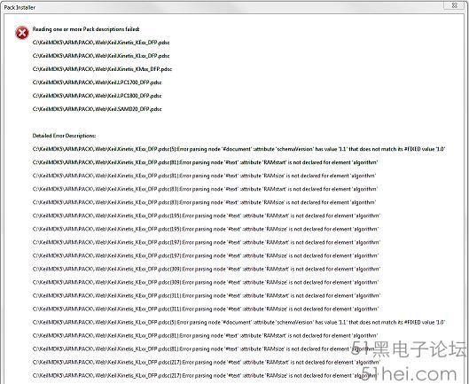

When the pack installer of MDK 5.00 performs a 'Check for Updates',you may see the error message:
Reading one or more Pack descriptions failed
The error window may look like this:

On February 21, 2014 some new Device FamilyPack (DFP) files have been published in a evennewer file-format. The change from format specification V1.1 toV1.2 was necessary to fully support new devices. The error shows upbecause μVision version 5.00 (and later) andits Pack Installer are notdesigned to work with version 1.2 files.
On December 19th 2013, some new Device FamilyPack (DFP) files have been published in a newfile-format. The change from format specification V1.0 to V1.1 wasnecessary to fully support new devices. The error shows up becauseμVision version 5.00 and its PackInstaller are not designed to work withversion 1.1 DFP files.

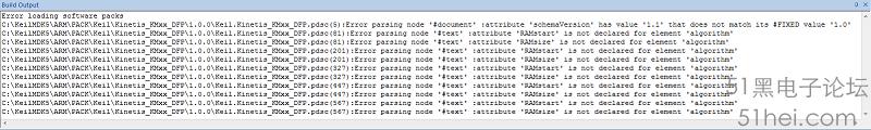

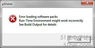

Please note that it is possible to install a new DFP manually onMDK 5.0 but μVision will not be able to use the new devices. DFPscan be downloaded from http://www.keil.com/dd2/pack/ andcan then be imported and installed withthe Pack Installer. Whenever μVision 5.00needs to read the device database, the following error messageswill show up:
