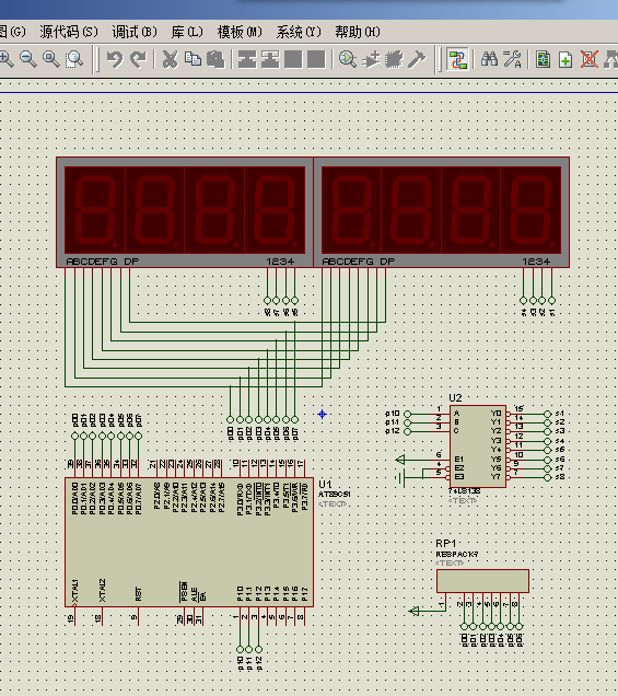

LED數(shù)碼管拉幕設(shè)計(jì) 程序和仿真
51單片機(jī)做的LED數(shù)碼管拉幕仿真

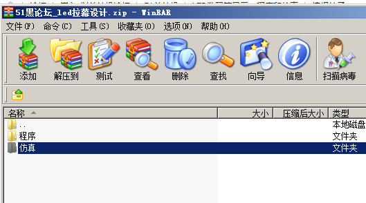

led拉幕設(shè)計(jì).zip (72.02 KB, 下載次數(shù): 9)
