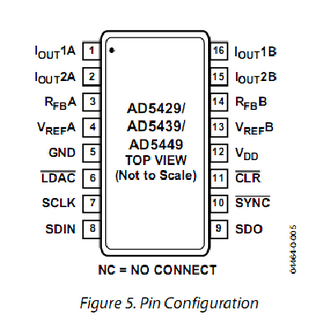

         AD5449 AD5429 AD5439引腳圖

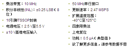

芯片的優(yōu)勢(shì)和特點(diǎn):
