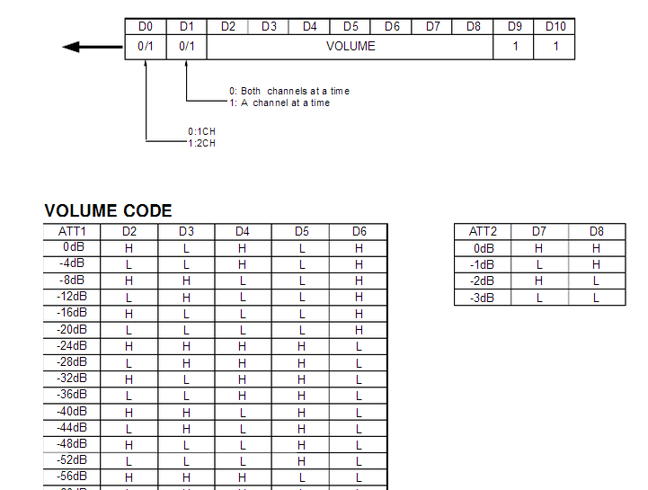

M62429音量控制
(*特別注意:最后D10位當時鐘線位下降沿時,數(shù)據(jù)線為高,以此判斷數(shù)據(jù)傳輸結(jié)束,否則,沒有音頻輸出)
stm32程序

const u8 vol_H4[]={0x03,0x01,0x20,0x0};                                                                                                    //D7.D8=0dB--(-3)dB
const u8 vol_l5[]={0x15,0x05,0x19,0x09,0x11,0x01,0x1e,0x0e,0x16,0x06,                                                   //D2--D6
  0x1a,0x0a,0x12,0x02,0x1c,0x0c,0x14,0x04,0x18,0x08,                                              //0dB-(-80dB)
  0x10,0x00

void set_volume(CHANNEL channel,u8 db)//AUX/CMMB
u8 L,H,i;
u16 volume;
volume=db;
volume=80-db;
L=volume/4;
H=volume%4;
volume=((0x00+vol_l5[L])<<4)+((vol_H4[H]<<2)+0x03);
volume=volume<<5;
RESET_DAT;
RESET_CLK(channel);
for(i=0;i<11;i++)
RESET_DAT;
delay(5);
RESET_CLK(channel);
delay(5);
if(volume&0x8000) SET_DAT;
else RESET_DAT;
delay(5);
SET_CLK(channel);
delay(5);
volume=volume<<1;
SET_DAT;
delay(5);
RESET_CLK(channel);
delay(5);
