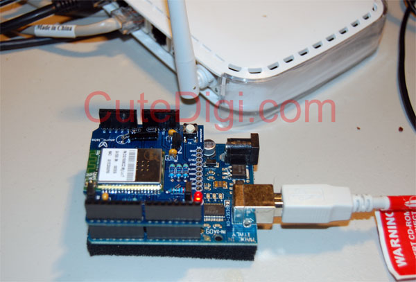

1. 所需要硬件
A. Netgear WiFi Router
B. Arduino USB board
C. Arduino WiFi Shield

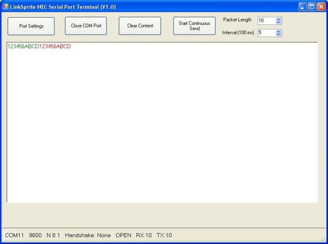

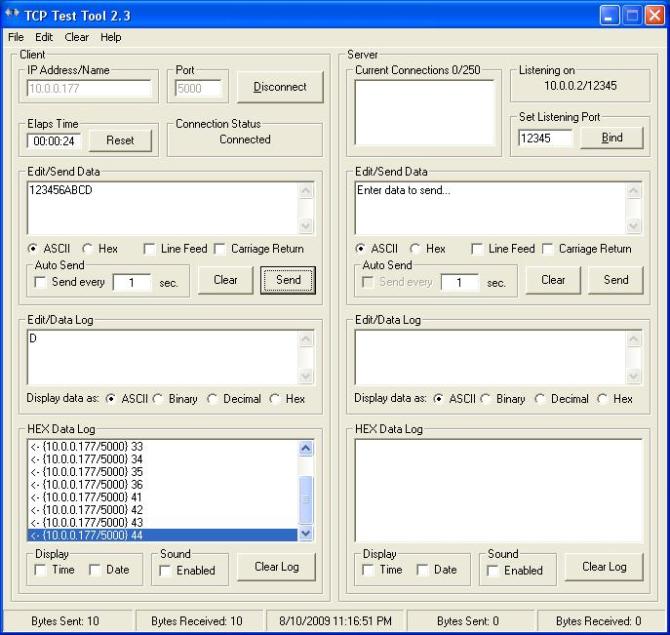

測(cè)試:
我們需要下載一個(gè)串口監(jiān)視器:http://www.torrancerestoration.com/f/LinkSprite-NEC-serial-v1.0.rar
TCP/IP調(diào)試器
