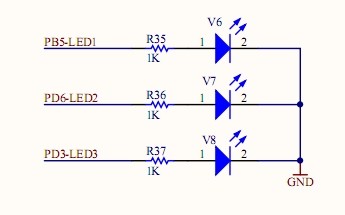

 原理圖:

  GPIO_InitStructure.GPIO_Pin = GPIO_Pin_5;     //LED1  V6   //將V6,V7,V8 配置為通用推挽輸出

  GPIO_InitStructure.GPIO_Pin = GPIO_Pin_6|GPIO_Pin_3; //LED2, LED3 V7 V8
